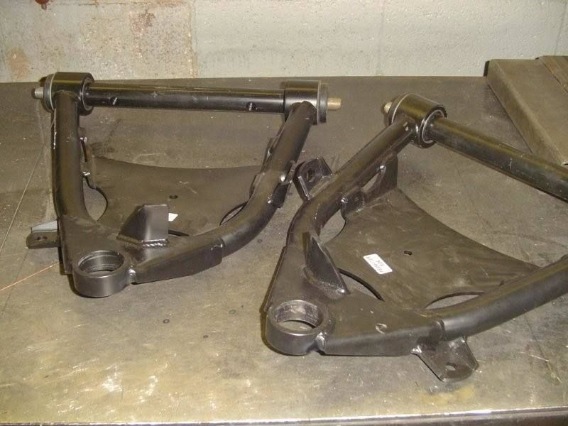

the original strongarms for a half ton C10

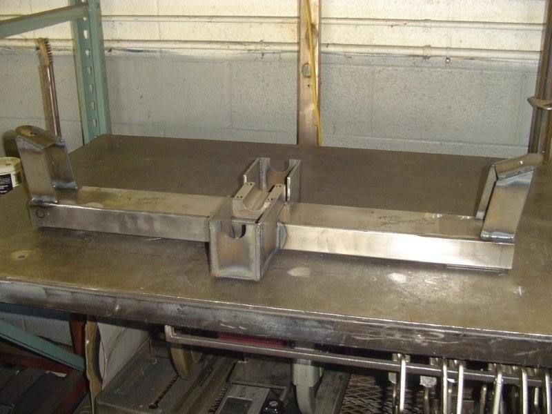

weldingjig (he can make them to order if you want to pay for them )

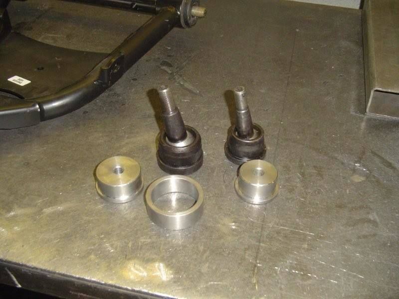

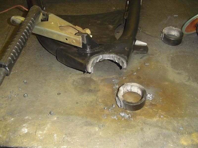

the bottom one ton baljoint compared to the original half ton and the bushes he had made to make everything fit
that voids the waranty for sure

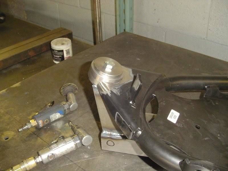

fitting the new piece

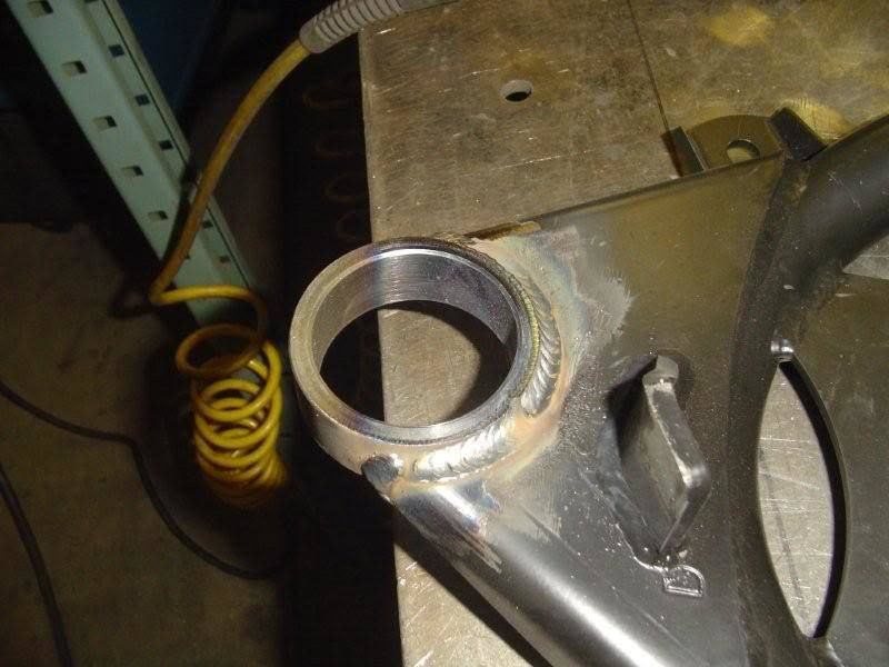

and the finisched product
the top ones dont need modifying to fit the balljoints all welding has been done to the bottom one .
the crossmember is welded the same way and i have to say it looks like a piece of art , this guy is an ace welder
