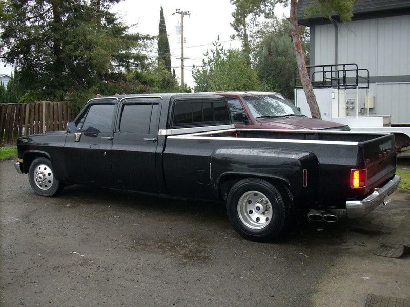

have you guys ever used western parts spec. 5/7 kit. or what is the best way to roll towing a 10000lb 24ft bumper pull. any input would help. kind of suck on either static drop or bag it.

If thats a pic of your truck in the first post, you have some meaty tires on it, which will cause some problems, what is the drop kit you have now?
When I first lowered my truck I ran a 2" spindle and 3" spring in the front and the back I did the flip kit with no notch but I ran some 2500lb firestones for overload bags. I ran stock tires for a long time but they did rub like a mofo. Then I went to the airbar on the back with a belltech notch, the western chassis notch would not work with the airbar. I ran that way for a year or so then bagged the front and went with a 3" spindle. THen I did a big notch on the back, added triple stack bags and it lays out on 19's, then did a bd at that time as well.

well to tell you the truth i bought the truck the way it is and do not know exactly wat it has in inches. i know it has slam ride bags in the rear with lowering leaf springs and in the front it looks like a coil drop and coil ride bags in them. this is why i want to do it all over again myself to ensure everything is done right. i really dont like the lowering leaf springs in the without a flip kit considering it gives me about 4" of total clarence between the springs and the chassis. i can see some rubbing marks on the chassis from them hitting. not good. as for the tires do you know of some tires that are E-Rated load. that would lower the truck more just doing that. would it be easier to just bag the truck instead of screwing with static lowering it?
