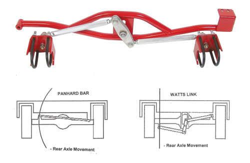

acts like a panhard bar but keeps the rear completely centered thru the whole range of motion of the rear end ...

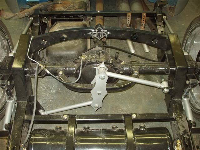

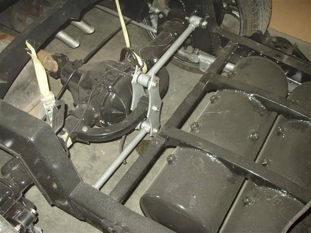

rhmdually
try area 53, they are in south florida and he built this one for his ranger.
his phone number is 772-215-4366.
low95xlt
damn thats impressive to say the least
