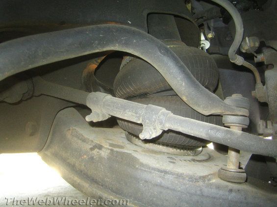

That's some hella rubbing up front man. Those look like Conti's to me, and they look softened up. Get them bitches out of there they are an accident waiting to happen.
Get some Slam Specialties for up front and you'll get a way better ride. More than likely it's a 7" bag up front. Check the diameter and get a slam 7 put in its place.

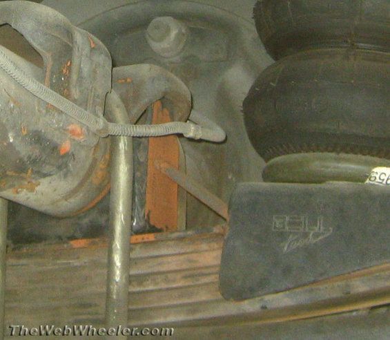

I think its some valving problem as well. the reason you get no lift out back it because it's bag over leaf set-up. Good for nothing more than towing and getting small amounts of lift. Your setup is alright though, it looks like the PO at least gave a damn. I've seen waaaaay worse in my day.
Thke a picture of the valve setup please.

i would check a faulty valve orfice or even possible since the bags look a lil worn there may be a chance that they are mushroming on the inside and having a hard time completely refilling once they are deflated.. jsut a ooption

definatly need to solve the rubbing in the front, as they will eventually burst. you definatly have a valve issue with the way it sounds to me. also the front bags are way soft looking, so i agree they prob. mushrooming. just my 0.02, brian
