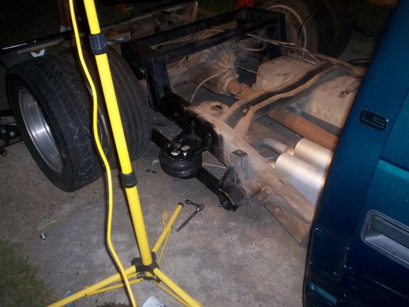

hey husker, would you happen to have any pics of the bars you made? i will probably make my own, just need to see a few pics if possible. ec can you send me a pic of the setup on your new dually? thanks guys, bgboy
E
ec_dually

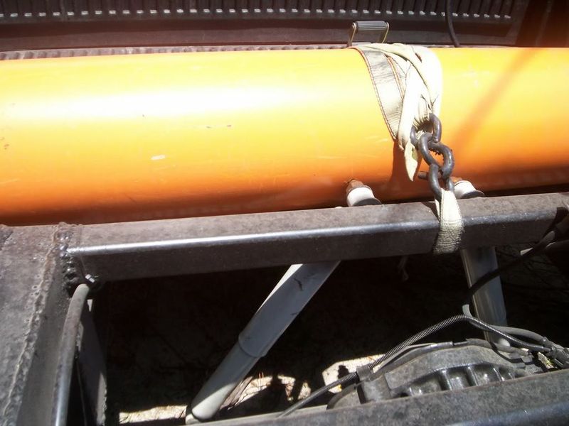

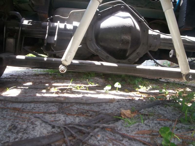

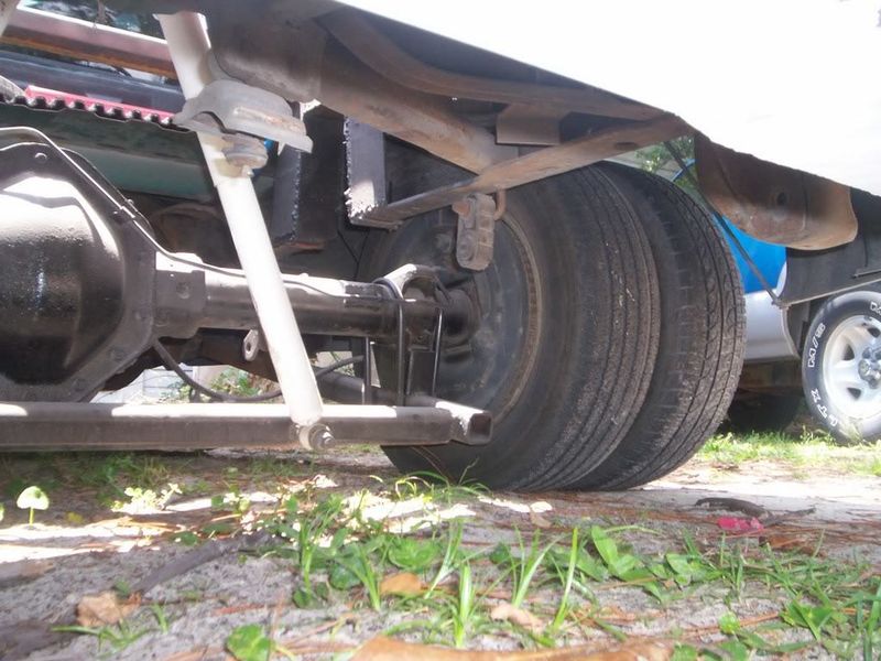

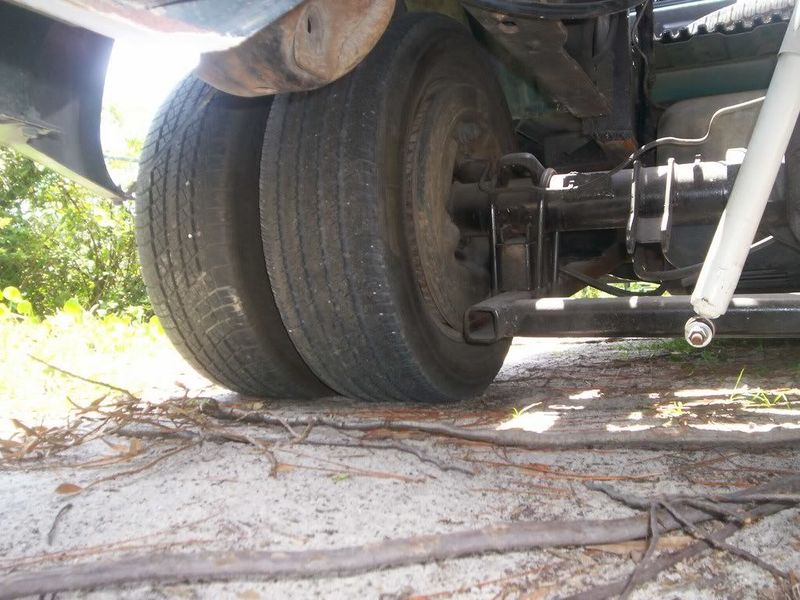

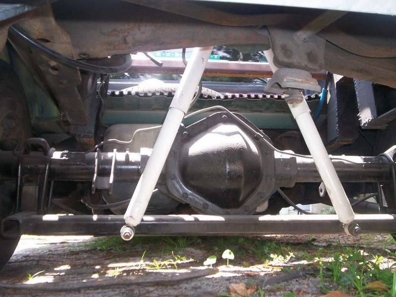

here is one of the link bars i have with the bags on the bars and i will get a pic of the rear of the bars tomorrow where i tied them together with another piece of box tubing with the shocks on there... ...
