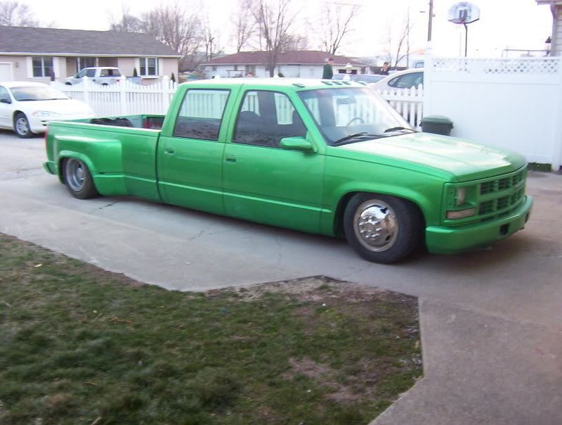

I am new to the site and I know that this question has probably already been answered thousands of times, but I can't find a search button or the exact answer I am needing. I have a 97 chey crew dually, slammed (of coarse) on fbss, running 3" drop spindles in the front, a parallel 4 link in the rear w/ airlift 1r9's on custom lift bars, I am needing to know what I would have to do to be able tuck 22's front and rear. do you have to modify the rear fenders? and do have to lose the inner fenders up front. Also where is the best place to get a good deal on these wheels? Also does anyone tow on these wheels?

You will more than likely have to lose the front inner fenders unless the pic you have posted is as low as the truck sits, then it will be real close to working with some 22s and the inner fenders.

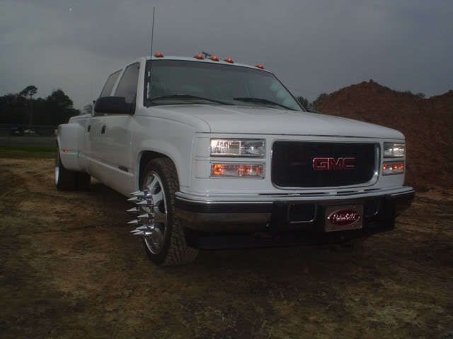

Here is a pic of my 99 with the "TowNasty" wheels that we speak of.
low95xlt
drag my girls jsut saw the spikes and she was like damn i like those so she said i could get a dually oo hoo
