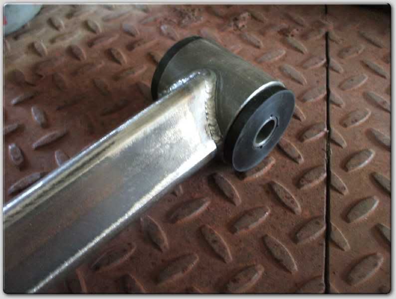

Hey Kyle, can you post a pic of they're bar ends with the outer sleeve!?

Here are some pics. I get mine the same place as Guilty. I have about 50 sets in stock with and without sleeves.
Bushings $4.99
Bushings and Sleeves $9.99
Bushing and Sleeve w/ threaded ends $19.99

Also have the Super Pivots assembled w/threads and unassembled w/o threads.
Unassembled w/o threads $29.99
Assembled w/threads $38.99

^^^That is awesome.
