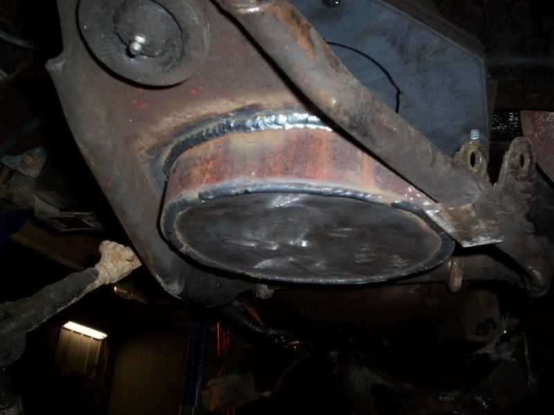

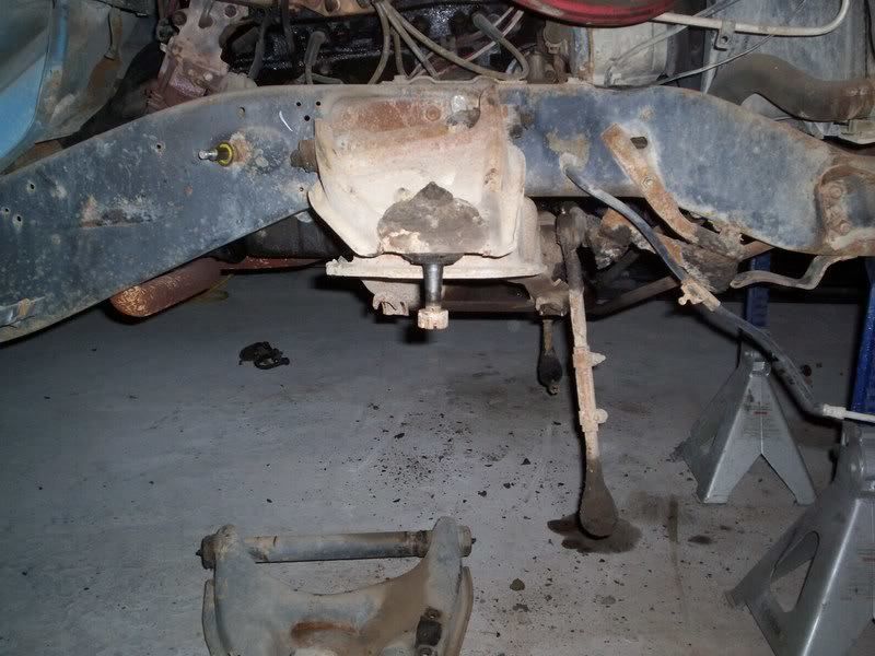

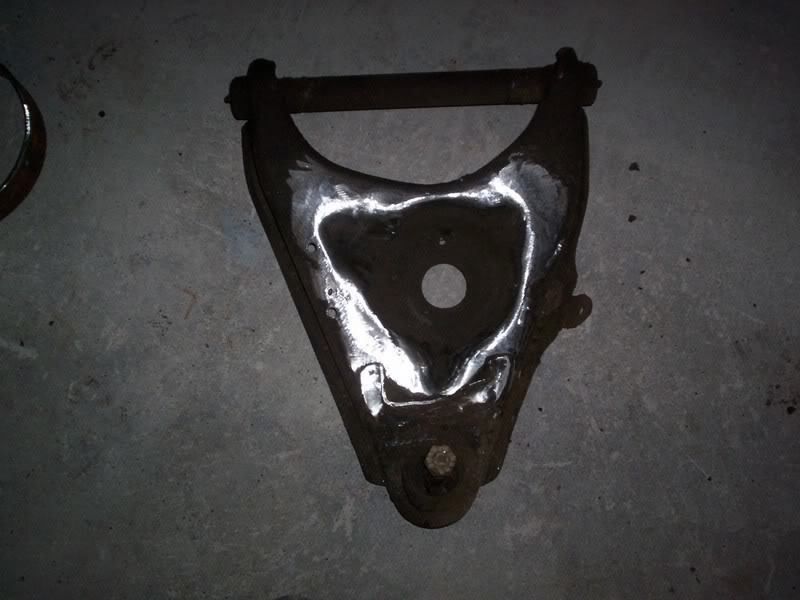

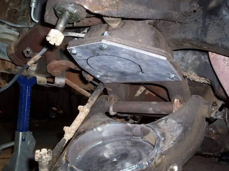

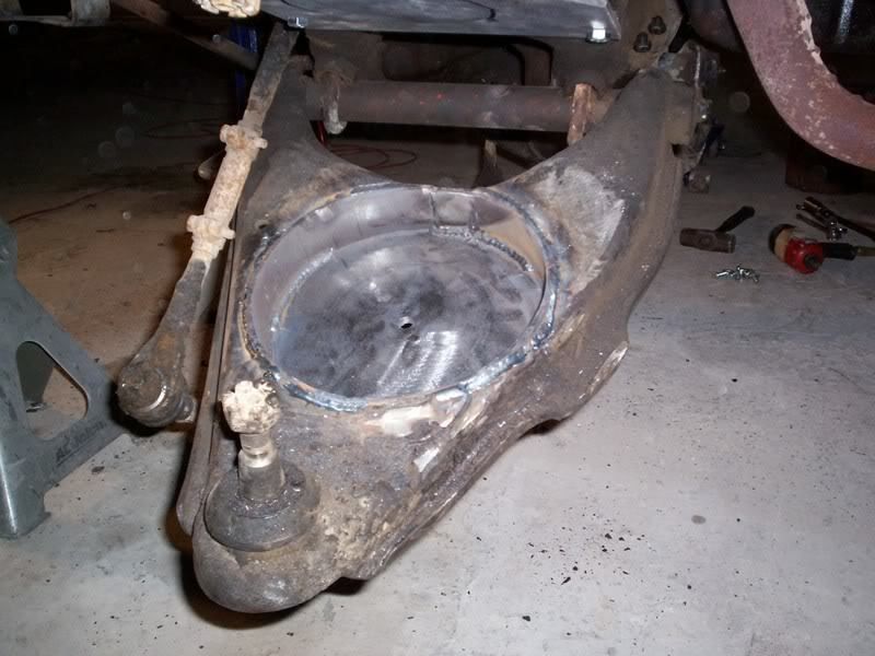

here ya go, my bags are RE 8's so there alittle fatter
With out spindals...about 2 inches from laying in the front
