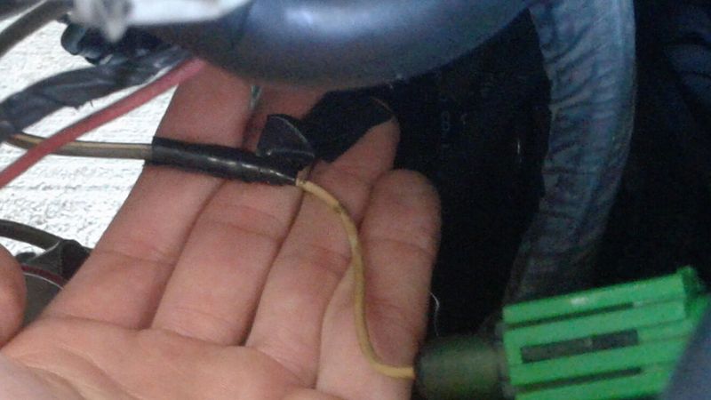

Ok sorry for taking your thread hostage. Stock carb, yes. Mikuni, idk.
So i followed the o2 sensor at the connector and on the truck side of the connection the wiring is frayed a bit. Idk if this is supposed to be grounded to something or wrapped. Thanks tweak
b22bomber
Heres a picture. Theres exposed wiring threading off in the area around the black tape. Does anybody know the deal with that?
