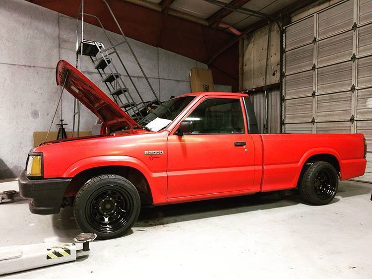

1987 Mazda B2000 5 speed. Bought it all stock with 190k miles on it. I have had over 50 cars but never a truck. So this is my new project / daily. I work at a specialty shop that dabbles in a few different cars so I have access to a lot of useful toys.
I will try to stay up to date on here but I post all the time on Instagram @jdmellor28

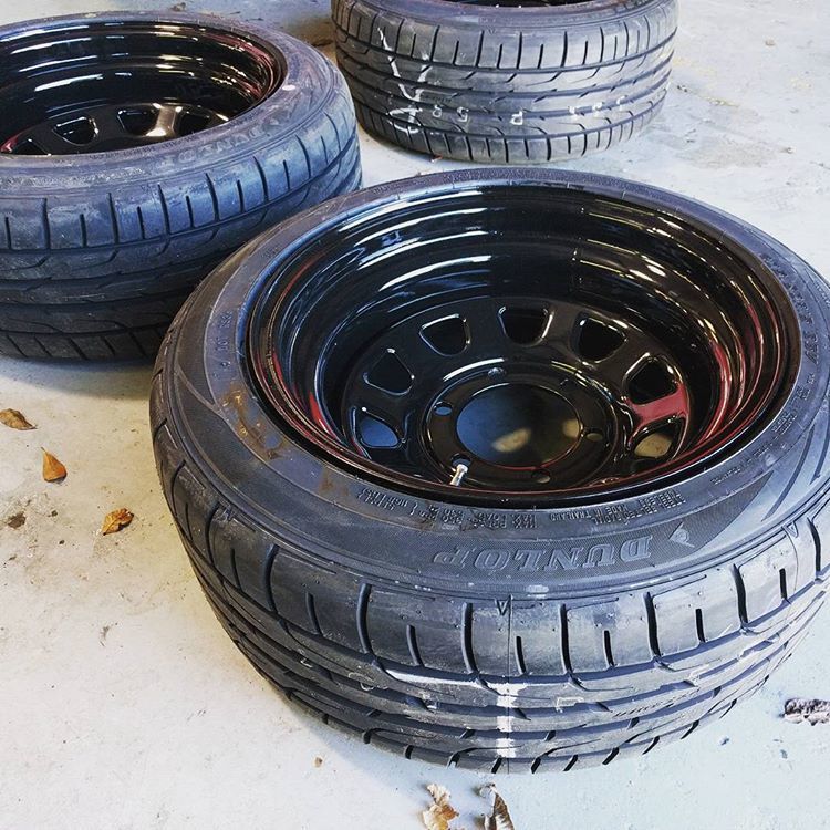

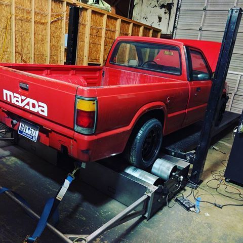

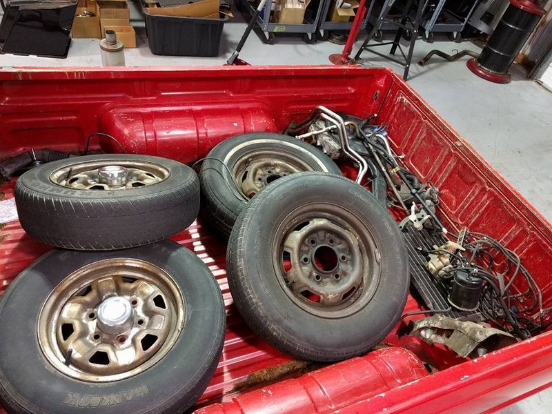

Up to this point I have stripped the engine bay of all the unnecessary junk, lowered it about 3 inches, installed new wheels and tires, new water pump, new front brake pads, weber carb, ghetto fixed the blower motor, got a custom 2 inch exhaust put on, and ran it on the shop dyno. The last dyno run proved to be too much for one of the valve spring retainers so now the engine is coming out so I ca fix everything and do more cleaning.
BTW it made 68 hp at the wheels and like 110 torque before it broke.

You dynoed a stock B2000 engine? Were the results surprising?
