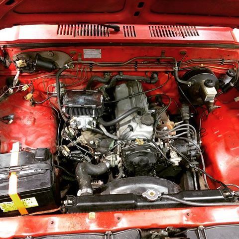

My motor at the moment. I took some stuff off for the motor removal.
sincitylocal's avatar
sincitylocal
Every vacuum line coming from the stock carb(and the crap they're connected to) except for the line to the brake booster, and the vacuum advance on the distributor. Also, the PAIR hoses can be deleted, if you choose to ditch the factory air cleaner.

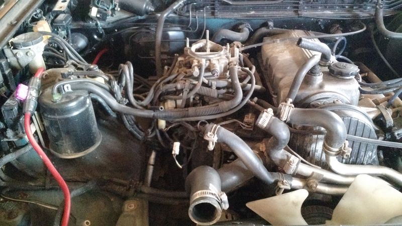

Here is what mine looks like. Got rid of basically everything
