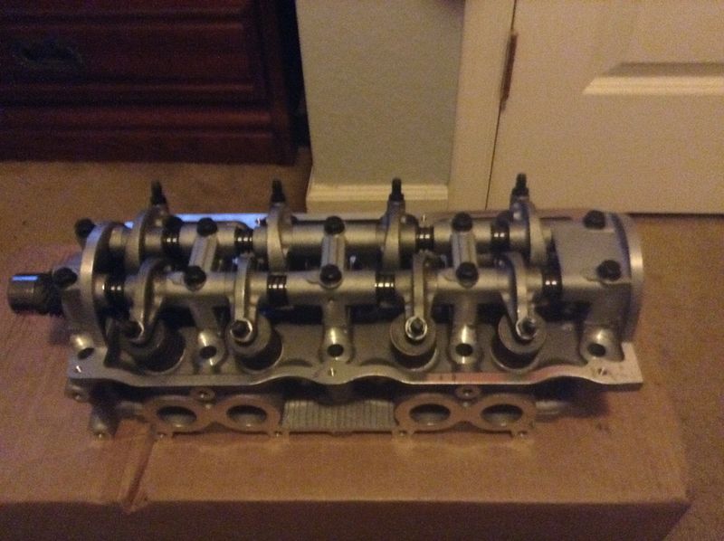

I don't know why the photos of the new head uploaded. Lol
