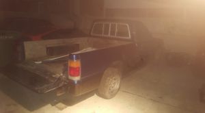

I'm looking for help on doing a b2000 5.0 swap, posting this on the projects area as i would like to document everything.
