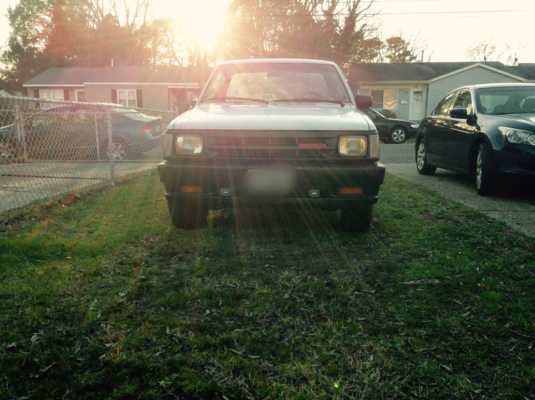

Not starting back up after ran for a while. I have replaced the spark plugs and wire set. I also replaced the battery and terminals and had my alternator tested. This is my first b2200 and I really like it but I am tired of getting stranded on my way to work. Any ideas or suggestions would be greatly appreciated. Thanks
