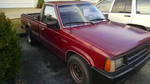

Just got this truck off my dad. I rebuilt the bottom end after he got it. Was knocking real bad so we got new crank, oil pump,everything new. Few months later it cracked the head. Ordered new head and installed it. Blew head gasket a year later and my dad said he'll with it. So now I'm planning on building a toy out of it for the summer weekends. Would like to stick a small block Chevy in it but worried about clearance for the distributor. Anyone have any advice or pics of a build. Would be greatly appreciated.

If you go with the small distributor, you can push the motor pretty close to the firewall. Go with the large HEI distributor, and you'll be cutting into the firewall for a notch.
I don't have proper build pics, but my truck is here. http://www.mazdatrucking.com/forum/showthread.php/4043-Che-Zoom!

Building a 350 for it. Got a 350 turbo and a 12 bolt rear. Gonna just tear it down to the frame and go from the ground up. Put a cage in it to tighten it up. Shouldn't be too bad. Was gonna go Ford with it but saw too many done with Ford powerplants because of the firewall issue. Thanks guys and any further advice is appreciated.

Well, change of plans. The SBC is going in my K5 Blazer. I'm sticking a 91 5.0 out of mustang in it. Gettin ready to start cleaning it up for paint soon. Will post pics as work progresses. Thanks for all the input guys. Really nice to have a place to get a heads up on any issues I may come across.
