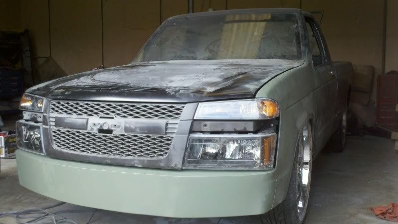

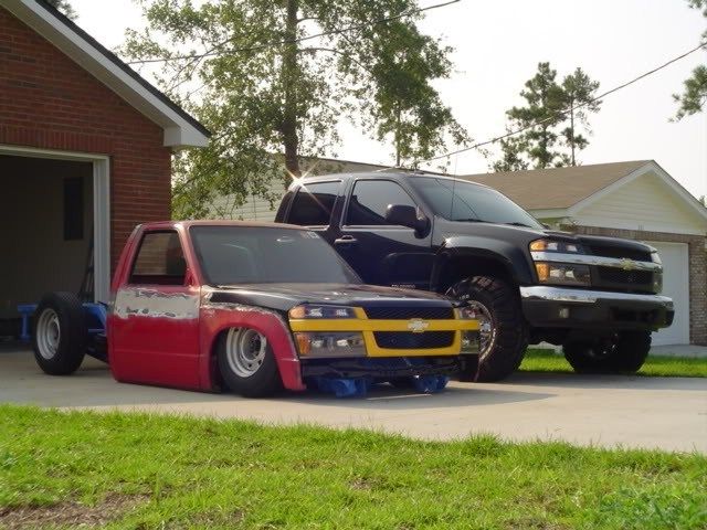

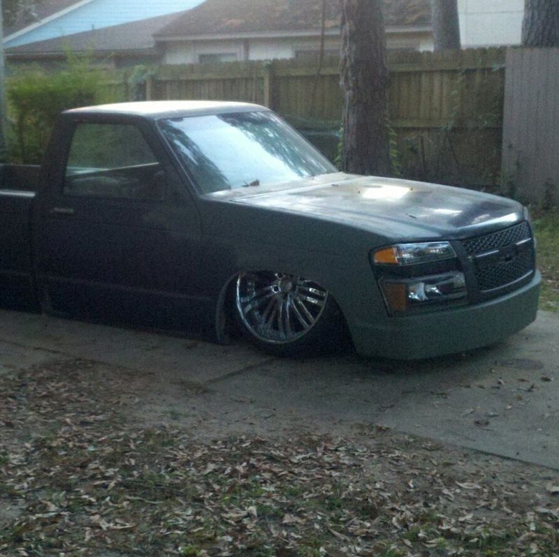

Ive done 2 of these. One of the trucks I sold the front swap and salvaged the other is still sitting in the owners driveway.
The first one I did was a normal front swap and was easier than the second one. The second one I did laid a 22 and had the fenders raised 1.5" to clear the tires.

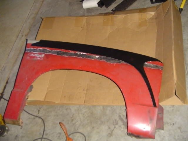

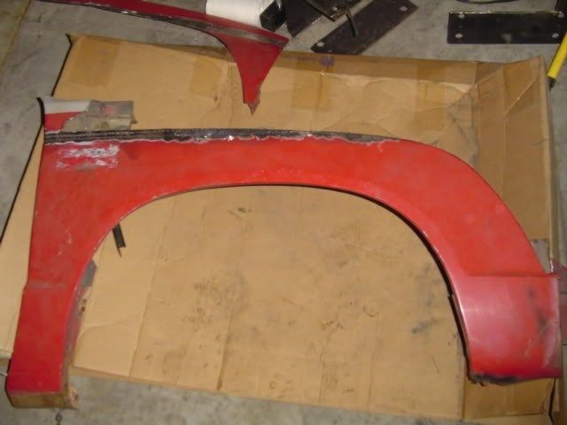

1. where did you section fenders?.
You will cut the rado fender along the flares bodyline then take the top part of the fender and trace it onto the s10 fender and cut it out on the line you traced out.

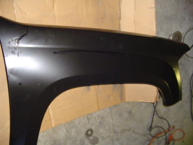

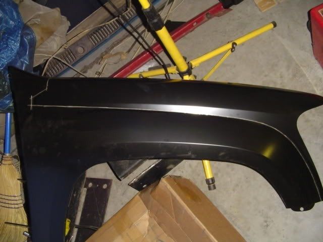

In this pic pay close attention to the top part of the fender closest to the door. You want to start your cut on the rado fender right before it starts to curve upward here and then cut over to where the bodyline stops bc you want to keep all of that bodyline.

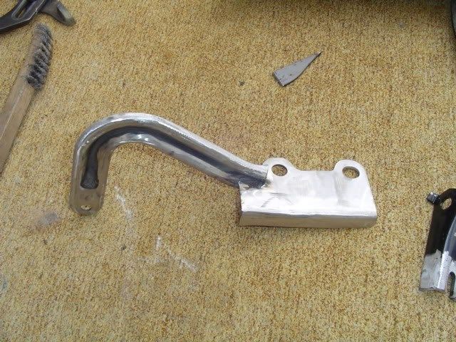

Q. What do you do about hood hinges?
You can either make ones that adapt the stock s10 hinge to the rado hood like I did on the first one or you can adapt a different type of hinge like I did on the second one. The second one I did used gas struts and hinges from a ford sporttrac. Here's how I did the first ones.
The flat piece is part of the stock rado hinge that comes on the hood. The other piece is part of the s10 stock hinge.

very cool , thats what i was looking for thanks again .
