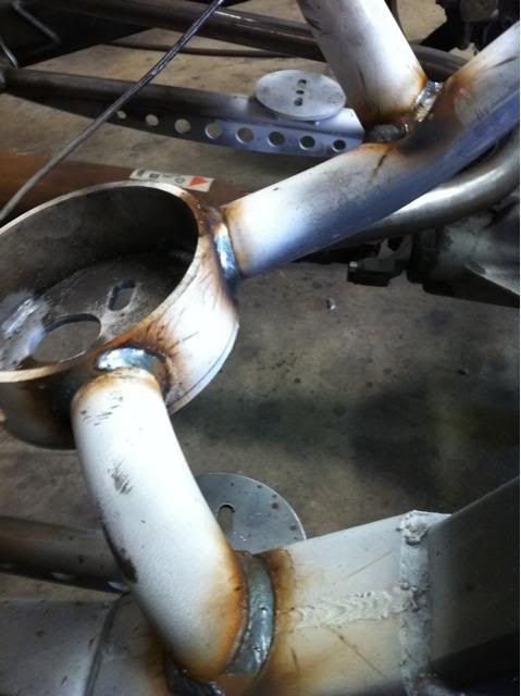

Yea, like these. I am going the make-my-own route. I got some tube and circle plates. Just curious, what would you guys charge for 2" cups like these??
Sorry to jack this picture, but it's perfect.

I think the circle plates are around $5 ea (so $10 for the pair) and what every they charge for a foot of the size of tubing you need. Pretty easy to build though, I'd cut it heavy in the bandsaw, face it to size on the lathe, and then weld it up. Some people might think facing in the lathe is a bit overkill but they look nicer than being cut in a chopsaw or with a 4" grinder and cutoff wheel.... I guess charge them for whatever your time is worth.

Right on. I never got a pricing on the tube, but I was told it would be pretty pricy, mainly cuz it wasn't in stock. I ordered everything through a website, so next time I'll have to price the tube solo and see. Thanks for the insight.
