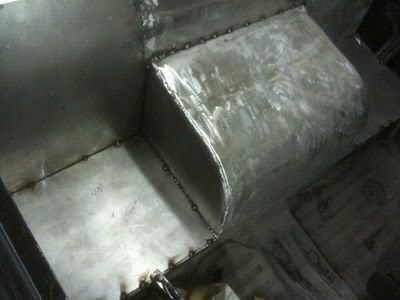

I'm building an 88 4 runner on what used to be an 86 Xcab frame. Here's how I did the rear.
It's built up with 1" square and 1/2" square tubing.
