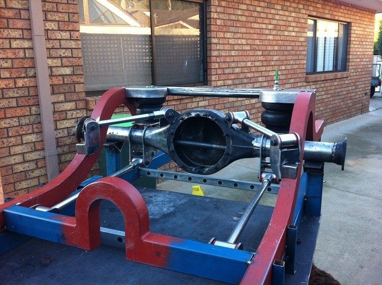

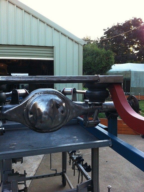

Just a quick one, This is my chassis / 4 link build. I have been told it may not work very well by some dude. If you could just take a quick glance and tell me if there is anything you would change that would be great!
Manually, it seems to work fine. At the moment everything is just knocked up and taced. The max pinnion angle change I seem to be getting is 5deg. I also want to use a two piece shaft. The front section will be straight and the rear will angle sligtly to the right side ( looking from the rear of the car ) is this ok?

im no max infact im not sure if he even gets on here anymore but i would make the uppers longer i just had to rebag a mazda that was set up almost just like that and it rolled the axle alot
