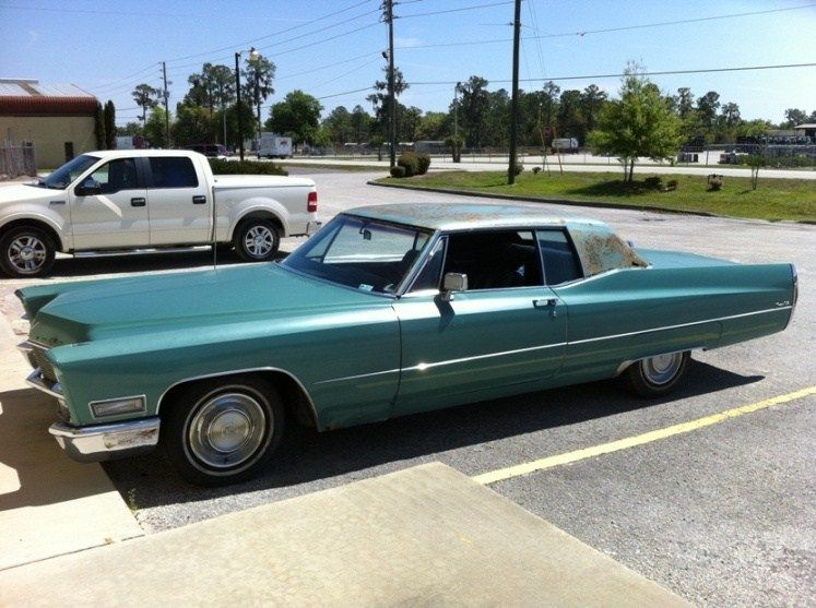

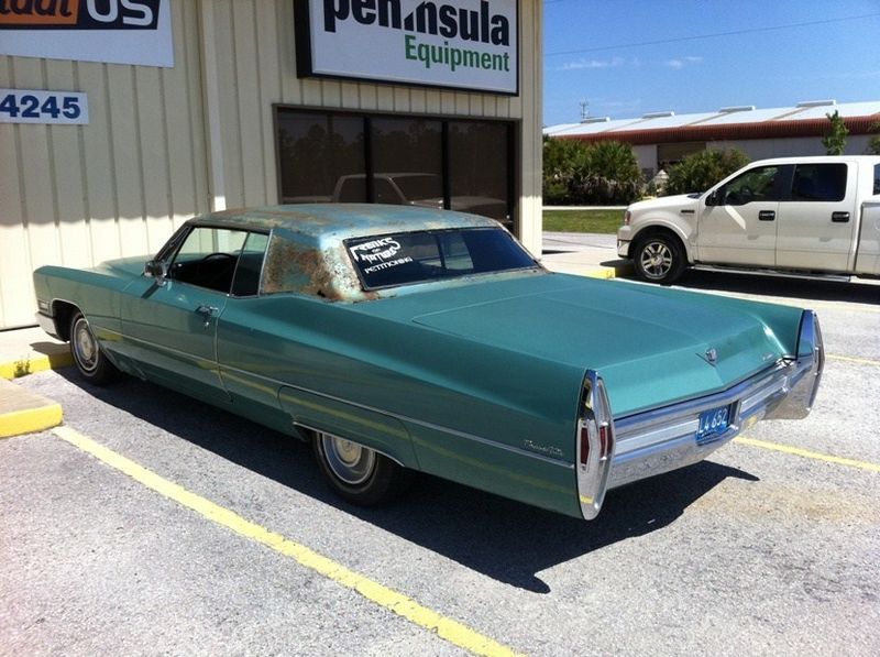

here are a few pics of it as it sits now.
