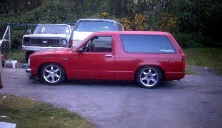

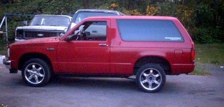

Firestones F9000's will get you about 8" of lift
This is from back in the day, but it gives you an idea of the amount of lift you can get out of an F9000...
I'm not sure how much more you need...lol
