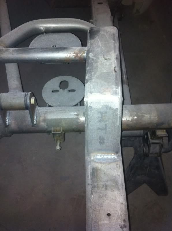

When I do those, I will notch the inside and top of the frame, slide the notch in, weld it up and re-plate the inside.
I did this one a long time ago, but it gives you an idea...no shot of the inside though :(

New body chevy

That's kind of what I was thinking, just trim the boxed frame to make the notch slide in.
