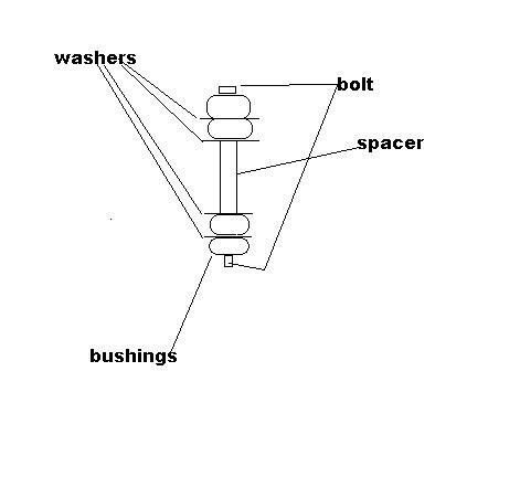

You can build your own. Energy Suspension sells endlink bushings. You then just need a grade 8 bolt, a spacer, and some washers for the bushings to sit on. That can all be bought at a hardware store. I made my last two sets.bought at a hardware store. I made my last two sets. Here is my crappy drawing.
