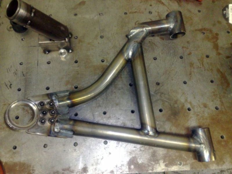

made for the mid 90s chevys they do the same as a 2 inch drop spinlde only dont have to change out spindle or if you do you end up with a four inch drop. these are narrowed .5 inch. they are made of 1.5x.188 cut and ground dom tubing. use delrin bushings and my 4130 bolt in uniball cups for 1 inch uniballs.

NICE>>>   So, willl these let you lay on a 24 WITHOUT cutting the frame for control arm clearance???

yeah they should with a small tire i can make them higher also if need be for bigger wheels and tires

sorry about the pics being small i finally figured it out. here are the big pictures of them. the price is $1000.00 for all uppers and lowers narrowed or lengthened to your specs. that comes with a 1 inch lower uniball and a 7/8 inch upper uniball. fully tig welded i also am currently making a whole front clip that would replace the stock one with the "z" uilt in to it for an additional $300.00. it will lay a 24 all you have to do is weld in place and do your motor mounts or buy them from me.
