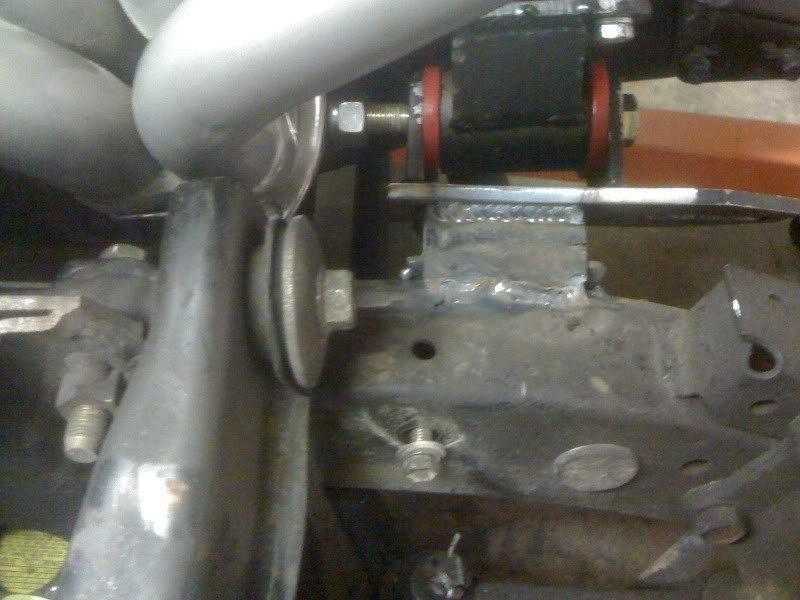

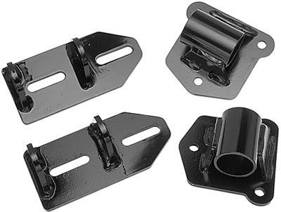

Wether clipped or not you gotta test fit the engine with the cab and all.  I put a 350 in my yota and bought transdapt conversion mounts.  But they didn't leave much clearance for the exhaust so I cut them and welded them in place to fit the block huggers.  I moved the frame mounts forward and then welded the conversion mounts to it backwards so the long part was forward and then I cut that part off.  You can how they used to be.  I think they make them for Ford small blocks also.  I put the engine as close to the firewall as possible to make room for the radiator and a/c parts.
