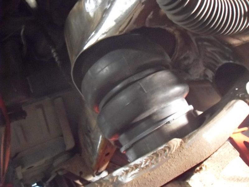

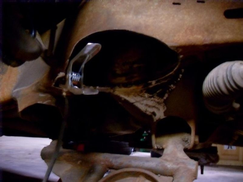

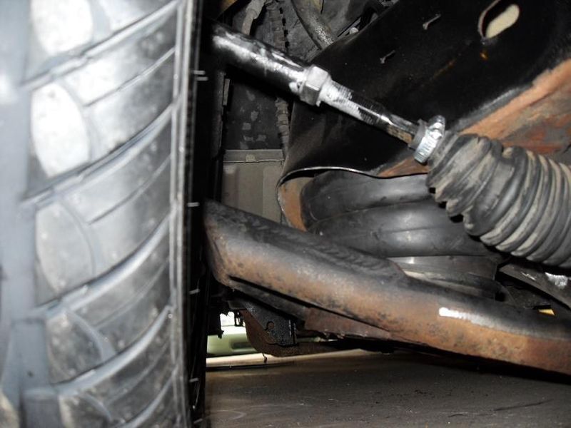

Hey DarkCyde can you pull a wheel off and show us some pics of ur front setup with re8"s
bigdaddypaco's avatar
bigdaddypaco
was getting ready to ask the same thing...

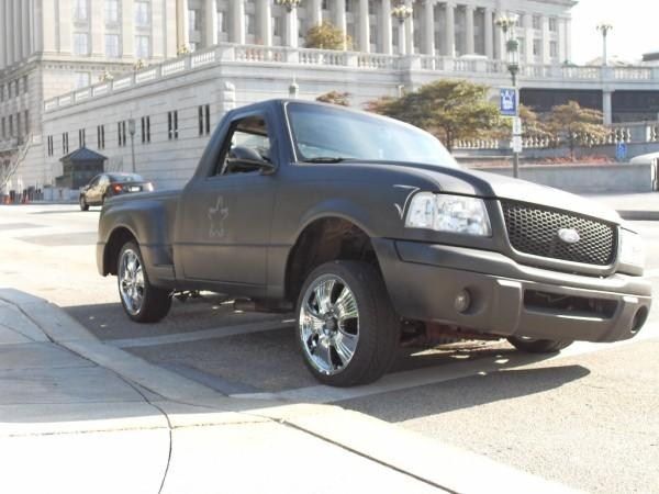

DarkCyde's avatar
DarkCyde
NP here ya go guy's I still need to cut out my inner fender area to lay out the rest of the way
