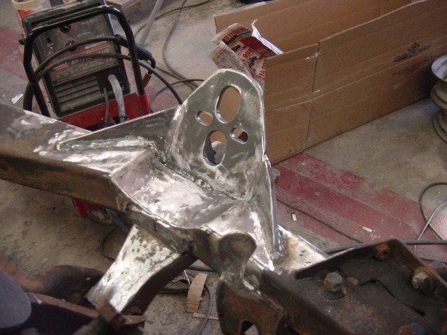

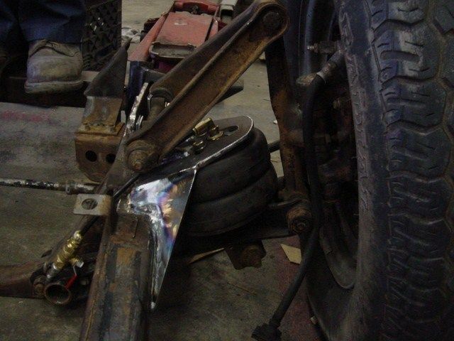

You can bag it with the stock suspension, but i would recomend cliping it.  I did my 521 on the stock clip the 1st time, and couldnt get enough lift.  When it wasnt body dropped it was fine, but once body dropped i needed more than the 8 inches of lift you can produce with a stock suspension.  All of this is going to depend on youir wheel and tire size. heres a quick pic:
