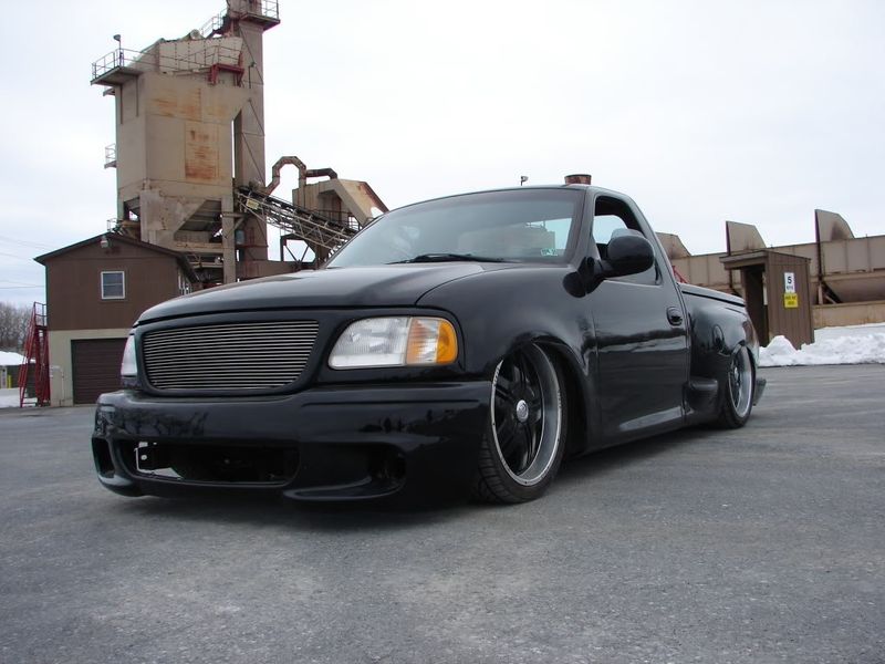

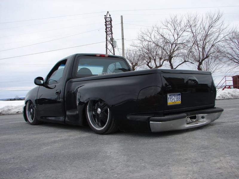

ok so i laid my f150 on 285 35 22s with no tubbingor booster change(used extensive lowers it helps alot)...my ?? is brian@keg help me out bud lol ...my ball joints are all the way in and my wheels still arent lined up..close but not perfect,any suggestionns??i moved my uppers left to right and raised them 2 1/2.....and one else have this issue?the fronts toe outward..
2- anyone use there stock tank location and tank. mine is in stock location but looks to be only about a 1/4 off the groung?what have you guys done

thanks 4 posting my pics ok figured out this screen name now lol..i built it in 3 weeks.... check out more pics @ www.myspace.com/fleck333
