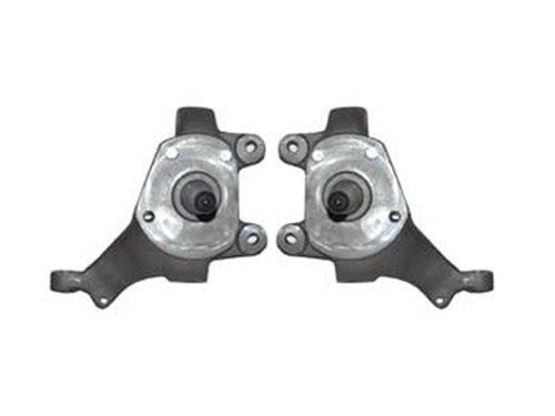

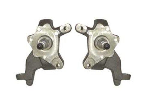

Oh btw, how do the AIM spindles use S10 lower balljoints? Because S10 lowers press into a sleeve in the arm, and obviously the Mazda arms have bolt-in balljoints. Also, if this is the right picture for AIM Totoya spindles, then thats what I have because mine have that hole in the ear on the steering arm, while the picture for the Mazda spindles does not: Mazda:
gslow2600i
the Aim ball joints come with a plate that has the ball joint pressed into it then it bolts to the control arm like the stock ball joint also if you need some stock mazda parts i probably have it.  If thats 215 motorsports truck he has my number
