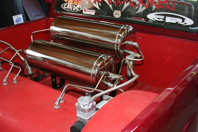

truck action's avatar
truck action
I put a safety blow off valve on mine, every shop / home compressor I've ever seen has them!!And not many if any truck/car compressors!Your tank if were to rupture will be like small bomb!!
truck action
Edited: 1/11/2010 9:12:24 PM by truck action
Edited: 1/11/2010 9:11:47 PM by truck actionYou can see the safety valve on thee right ,just to the middle of the leader hose
