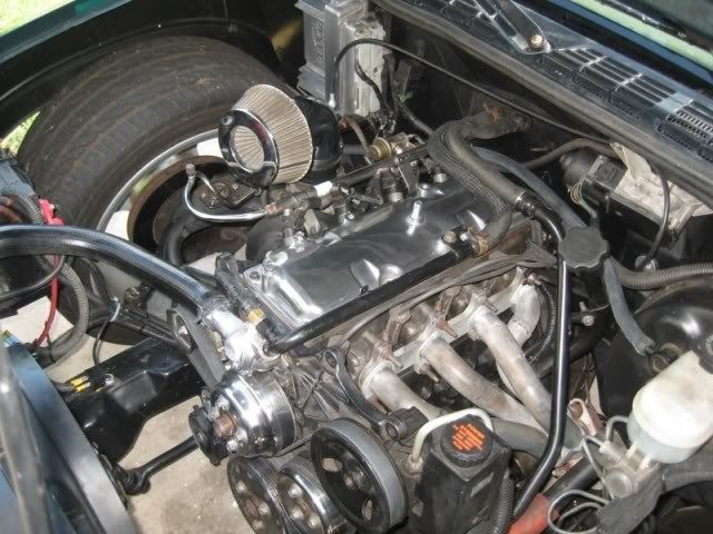

maybe im a little behind on this...you guys have the 2.2 4 cyl and you use the intake off a cavi for what reason?..clearance?...performance? does it clean up nicer ? just curious. got pics ?
menace's avatar
menace
---------------------------------------------Originally posted by dakotascrapinmaybe im a little behind on this...you guys have the 2.2 4 cyl and you use the intake off a cavi for what reason?..clearance?...performance? does it clean up nicer ? just curious. got pics ?--------------------------------------------- Yeah its all for clearance issues with body-dropped s10s       Lots of info here: http://www.s10forum.com/forum/f125/cavalier-intake-manifold-install-408853/
