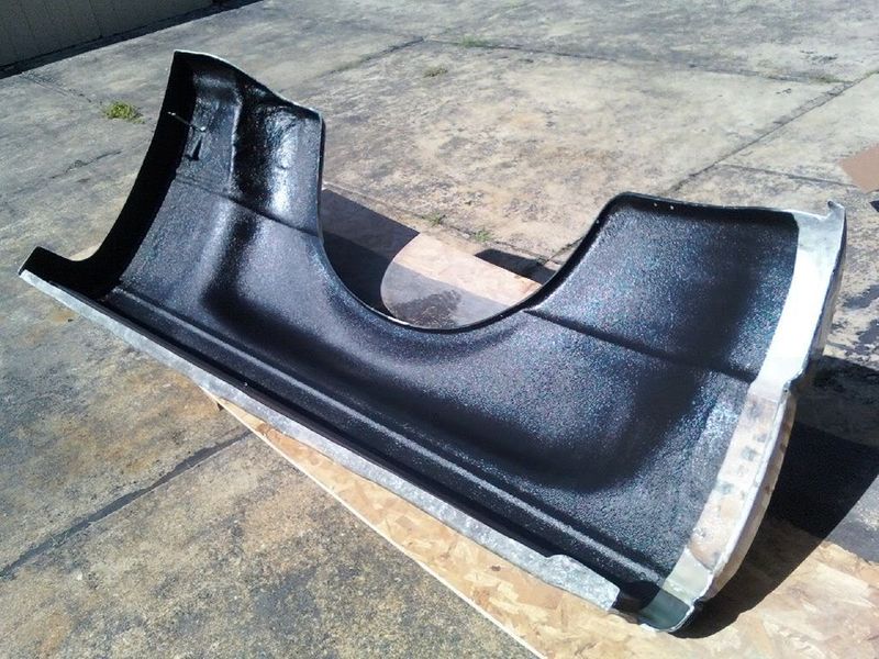

Composite Sides, Steel Inside...

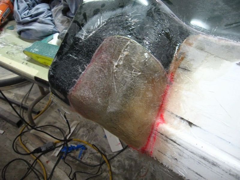

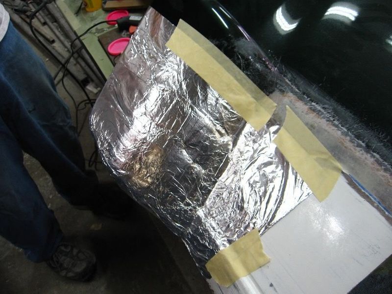

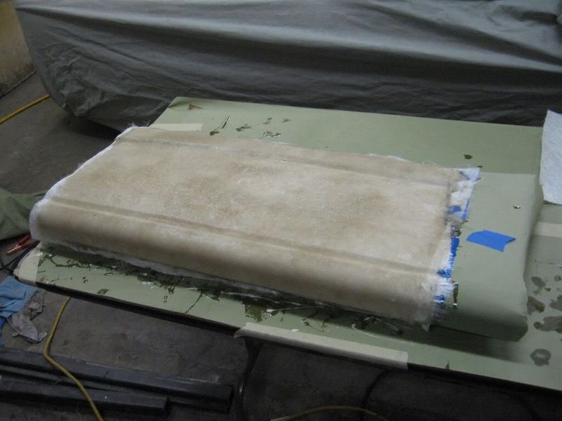

My Fat ass laying up some molds of the bed for the shaved gas door and the cab for the step shaver.

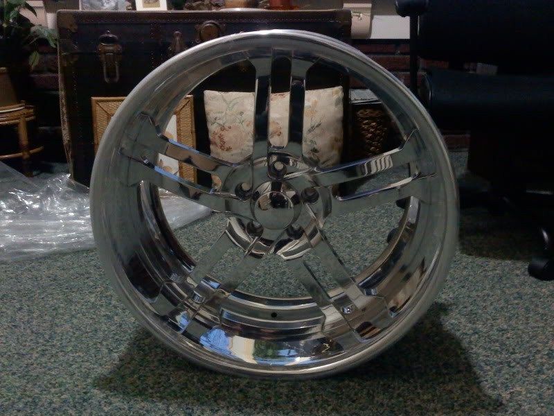

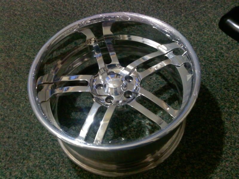

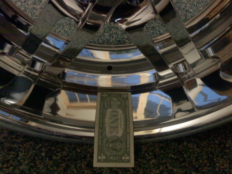

Yep 20 x 10's wil fit!
Molds off

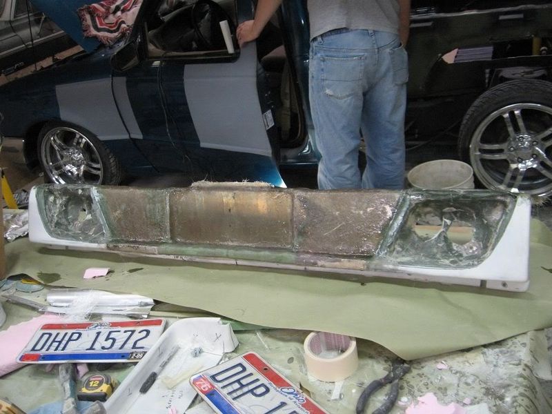

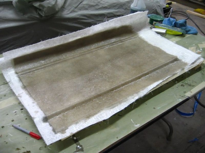

Making a mold of the tailgate for the rear shaver.
Using Molds...
Tailgate Mold.
I know it looks Silly but it actually worked well! The small sticks made it align with the cab really well and held it there while I glasses it in. Also I did rough up the body, the resin just makes it look shiny in the pick.

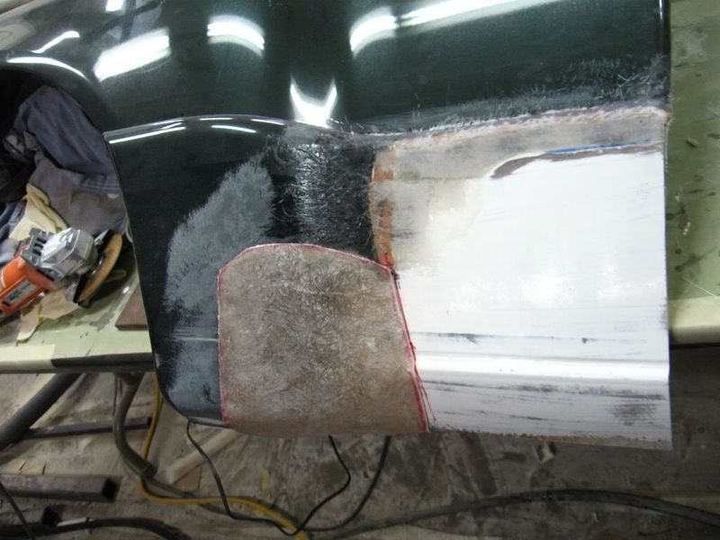

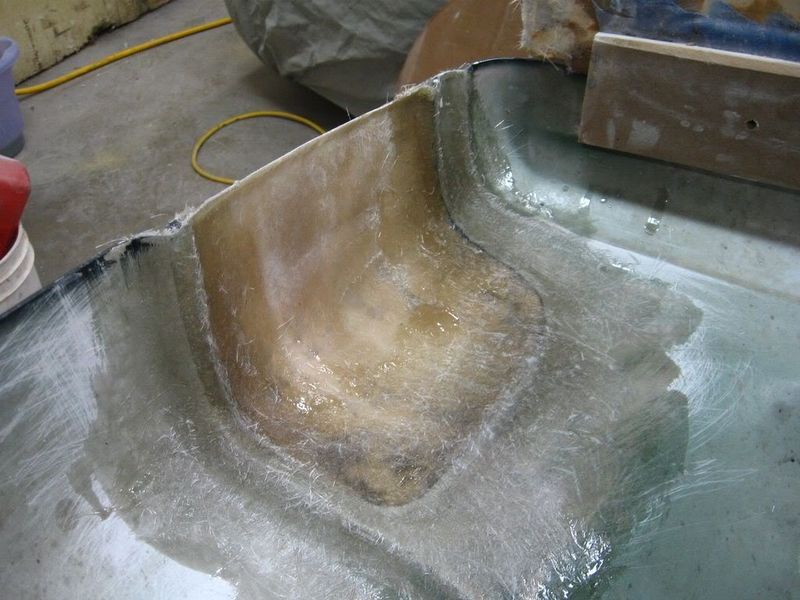

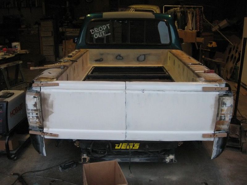

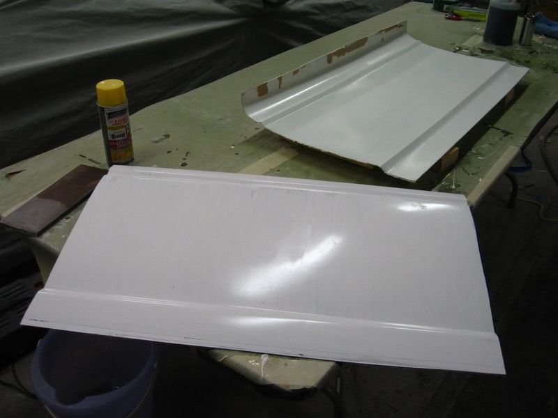

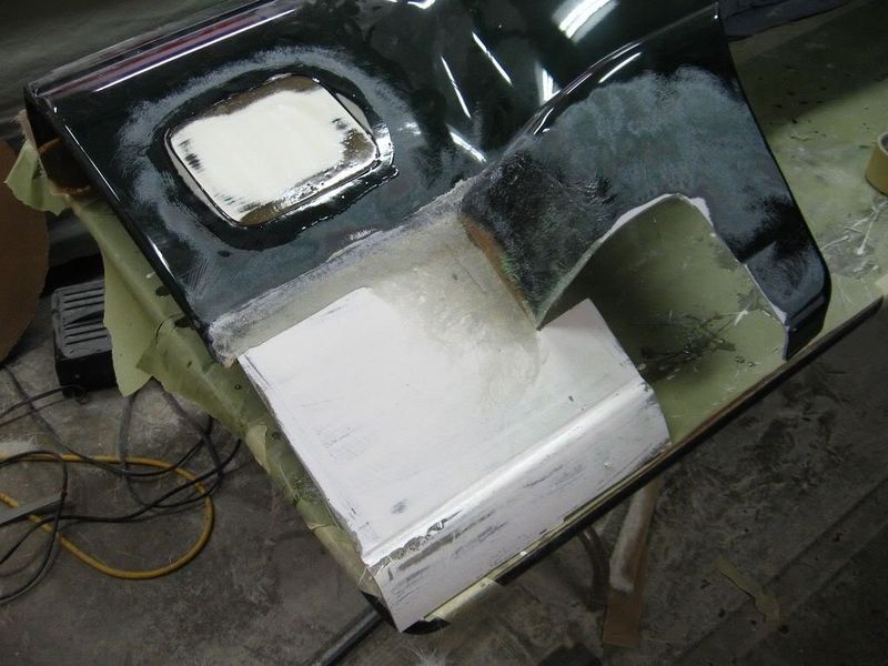

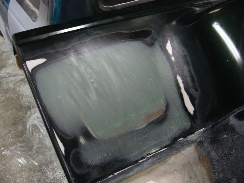

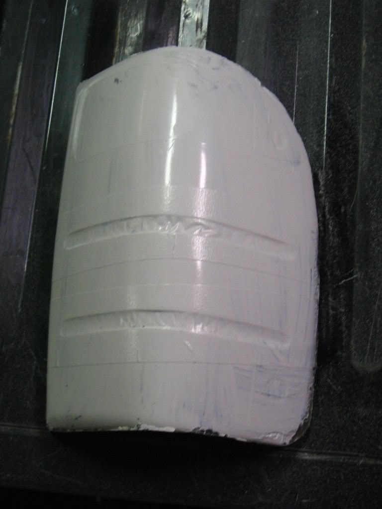

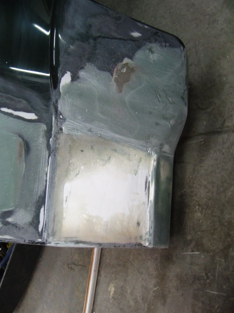

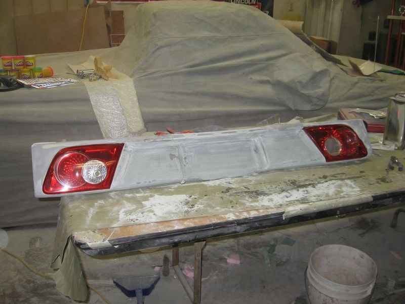

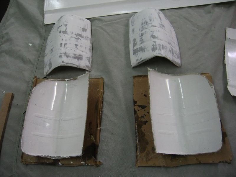

Tailgate mold Laid up. Tail Light Molds being made.. Tailgate piece Number 1. Tail Light piece     Gas Door Shaved and back of Step Shaver. I layed 2 layers on the face and 2-3 layers on the inside for strength(1.5oz mat) Typical of all the pieces on the truck Making Tailgate piece #2 Tailight Shaved Inside

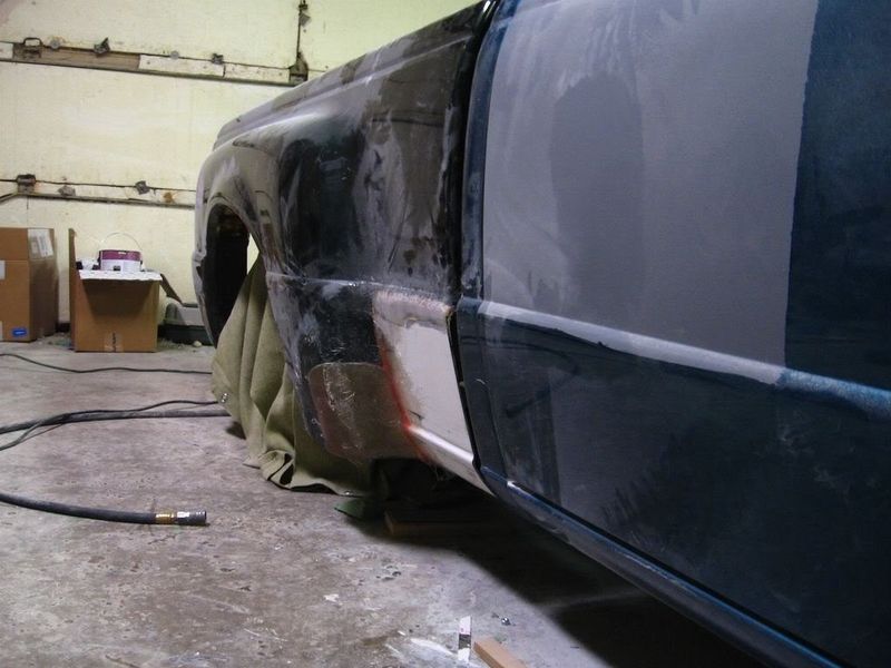

    More of Shaving the Step.

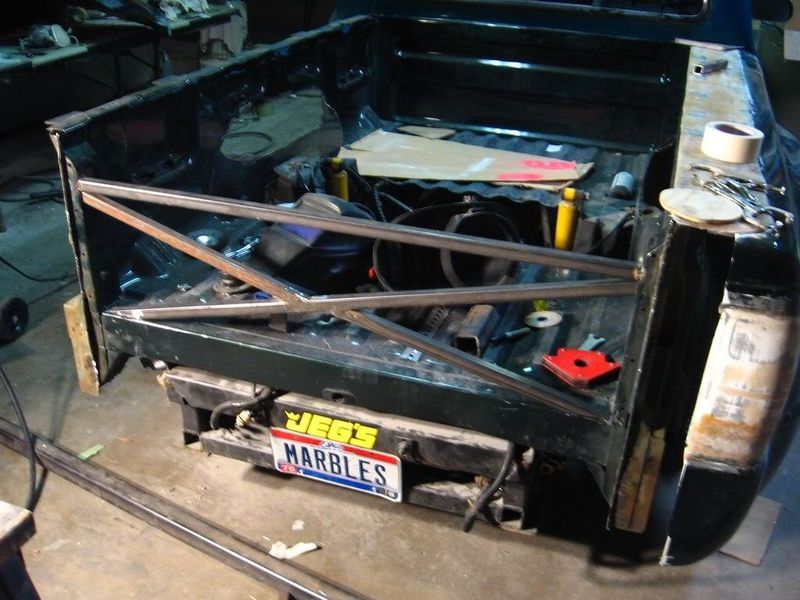

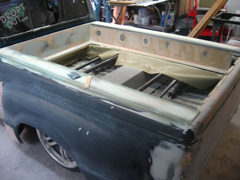

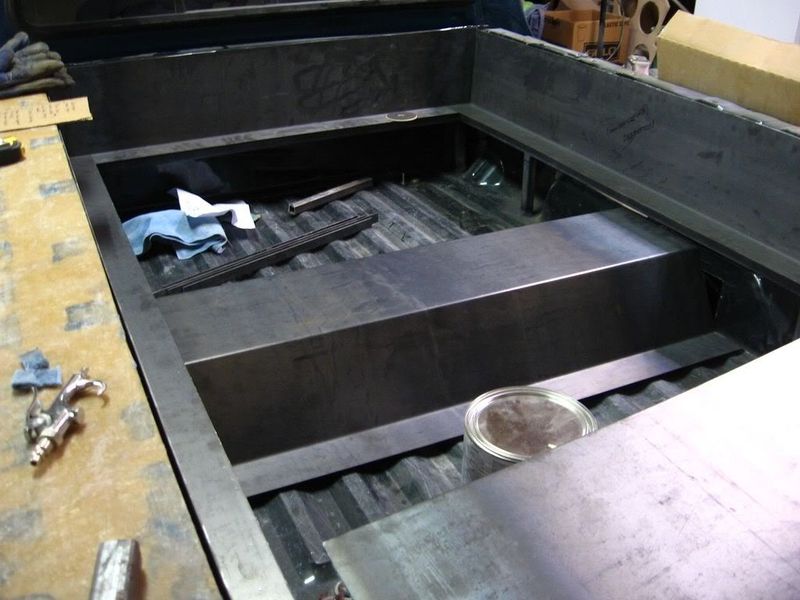

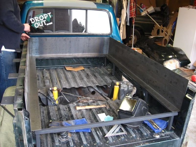

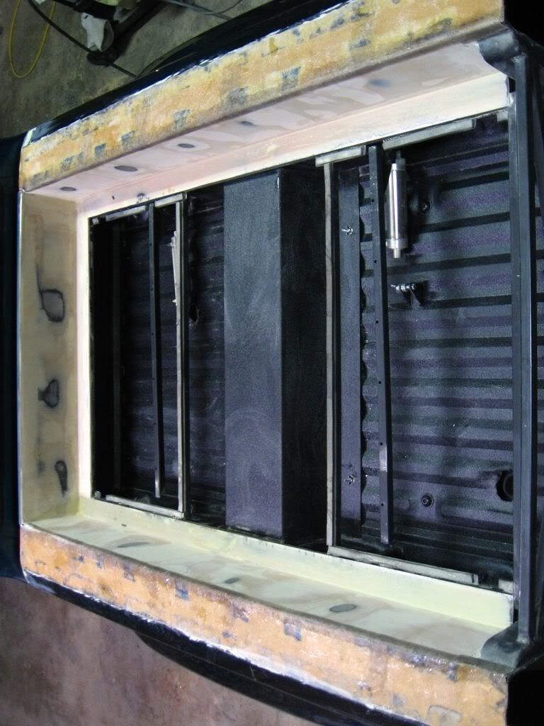

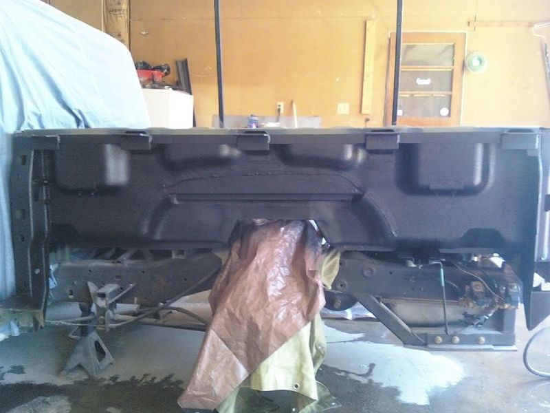

      Inside of bed Metal Work
Progress Pic!

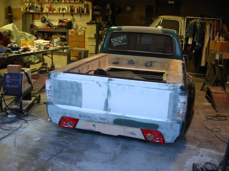

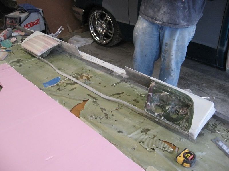

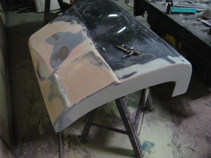

Start the Roll Pan. We started with a used fleet side fiberglass pan, cut 90% of it out and Replaced what we needed. The tail lights are out of a Mazda 6.

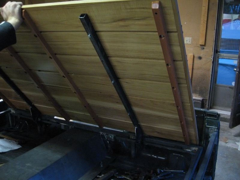

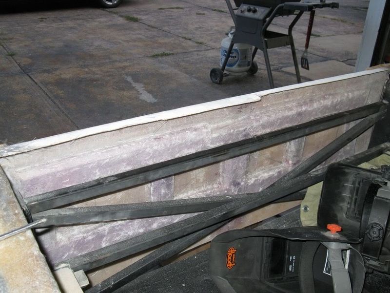

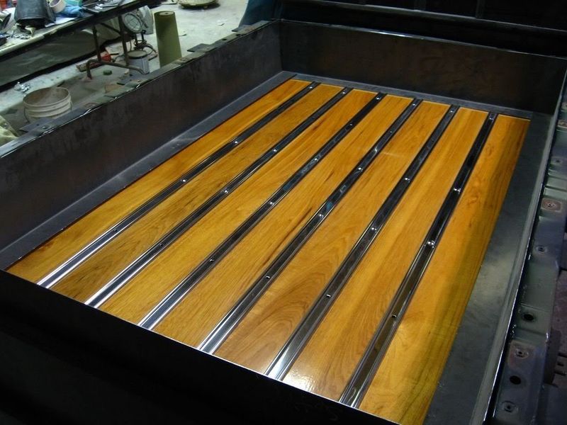

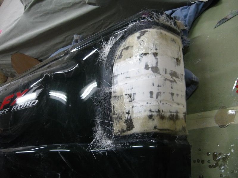

We did not make the wood floor. But If you need one made I got a guy...  Hinged? Oh yeah now its a trunk.  http://s29.photobucket.com/albums/c293/marbles073/?action=view&current=MVI_4387.flvRemovable Notch Raptor Liner kit. $100 and does the Job. Tailgate shaving begins. Cali Combo. 100% glass.

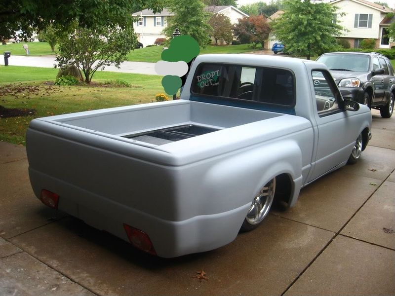

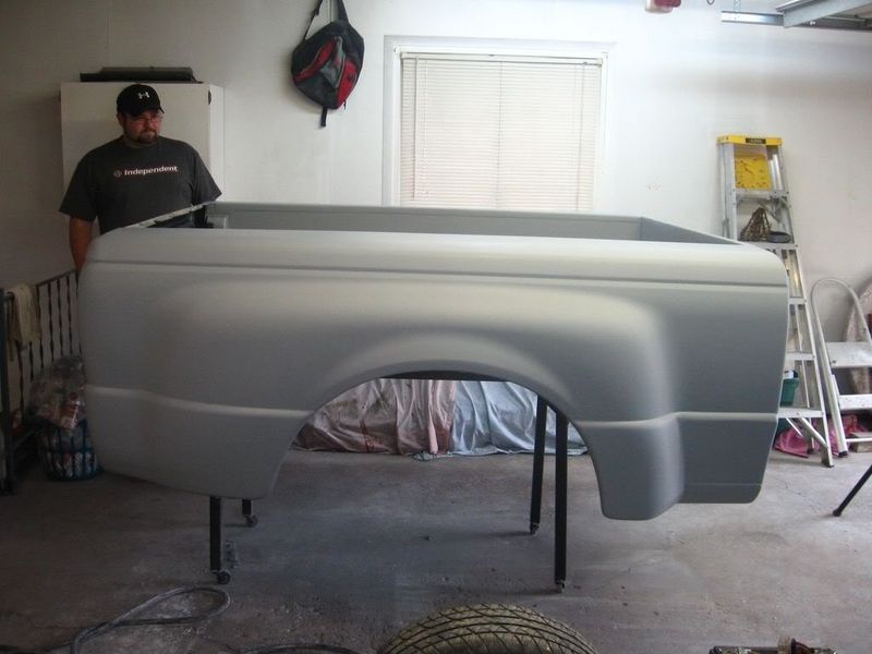

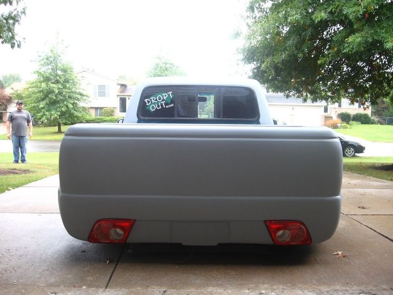

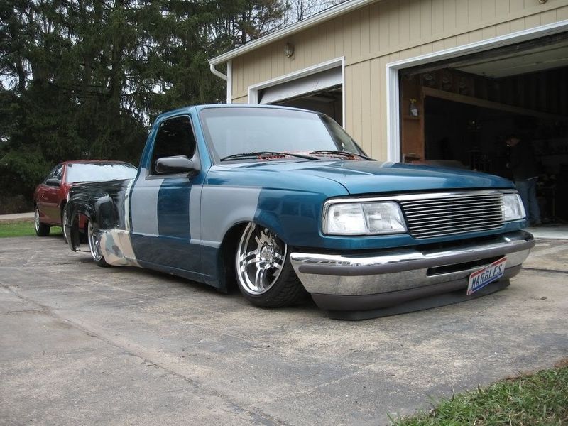

At the Painters. I will not lie I am no body man. So I get the body work about 90% there and hand it off. Rodney Bice took over and finishe the body work including fixing some things that were wrong with the cab and put this thing into light grey primer. Seth is going to roll like this for a season just to watch for cracks and problem areas. This way we can fix it before paint!

Truck is gonna be badass! Cant wait to see it with the wood floor.
JTB's avatar
JTB
i like this , i wasnt diggin the tail light until i saw it in primer flows good, good job!
