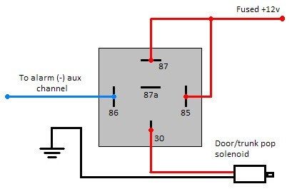

Does anyone have a wiring diagram for door poppers? Im not sure how to wire the relays ive never done it before
menace
Google is your best friend!
