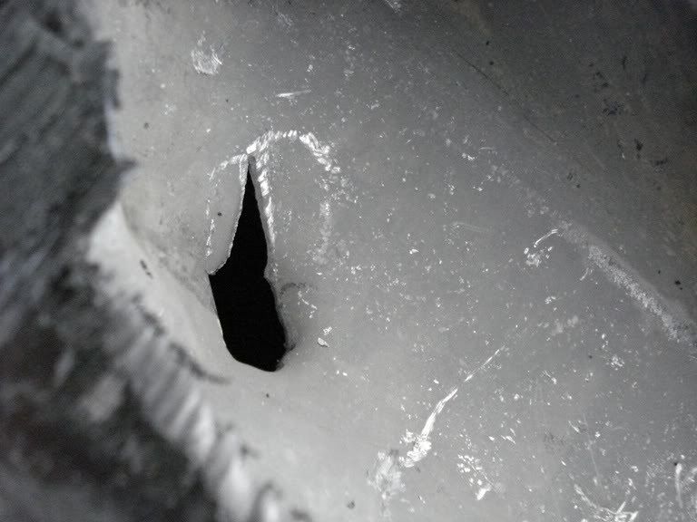

i have used the putty shit twice. still holdin strong. just make sure the outside of the tank is clean and roughed up with sand paper. follow instructions. heres a pic of the hole
