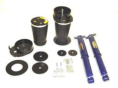

the front is the same as the s10....  the back is super easy because its basicall ya 4 link with coils. depending on what motor you have would determine what bag you use but a 7 inch bag is a good general size....  sweet project man i would love to see some pics!!!

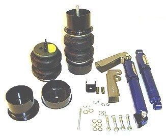

i have g body specific brackets in stock, 199 for front and rear, all bolt in, rear is also bolt in.  an re 7 is what i would use up front, if you like a softer ride in the rear go with a stone 2600 because its softer ride, tapered sleeves are the best bet for ride quality but it takes quite a bit of work to get one to lay out on a sleeve with all the factory mounts!

heres a ttype we bagged on tires that were about 26 inches tall when i say lay out i mean as far as the factory suspension will let it go, its fairly easy to lay one of these cars out with a small notch and brdge in back maybe some extending of the trailing arms, and a spindle and notch frame for tierods up front, or you can build some no notch tie rods

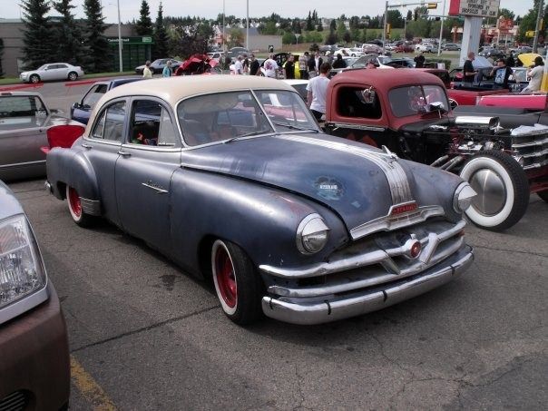

  heres the car what do you guys think?maiden voyage on a mild static drop lot of little issues but whatever
