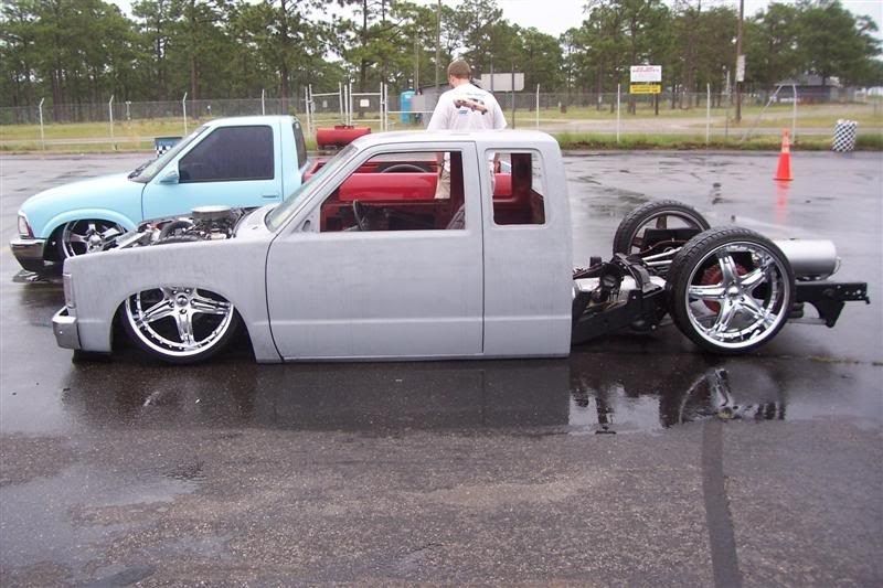

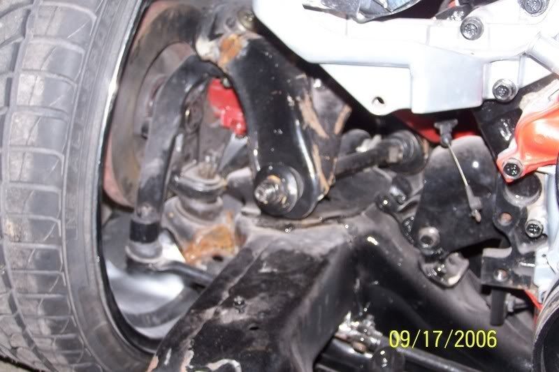

sadexcuse4s10
go on and talk some more shit about my arms man.  no i'm not some suspension designer, but the truck doesn't have any bumpsteer, alignment, or camber problems.   if you take a close look you'll see that my lower arms have the same angled profile as a set of tubulars available at SD, blf, wherever. sure they're not as pretty, but niether is an s10 frame full of mounting holes and covered in brackets.
sadexcuse4s10
Edited: 6/27/2009 11:38:18 PM by sadexcuse4s10
cutting up stock arms to lay a truck out on big rims is what got companies started on building control arms to lay trucks out.  how else would they have designed the jigs for the tubular arms if there wasn't a cut up stocker to test with. camber when laid out, around 5 degrees         and it gets enough lift to clear the fenders by 1" on level ground.  even after the tires stick above the fenders by 1 1/2" when laid out.  that's a shitload of travel for just some hacked up arms
