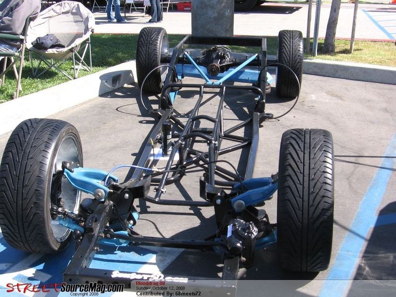

my toyota clip cost $200 from the firewall forward. I get roughly 9" of lift however we are still using the stock upper and lower control arms. With after market arms you can get upwards of 15" of lift. How my truck is setup there is almost no camber change through the cycle of the suspension.  So essentially I have $350 dollars into my toyota swap where a M2 swap is going to run you about a grand or so once you start piecing it all out. Also you can press the toyota studs out and the ranger studs pound right in. No changing anyting..  Here is my truck with a toyota frame.. Also the motor mounts are made by a company called Auto Fab.. If you need them they have TONS of them, and a lot of them for Rangers as well..

thanks for the info....now i just need shop around to see what a shop would charge to do this...im thinking im goin to go with a yota clip for sure
