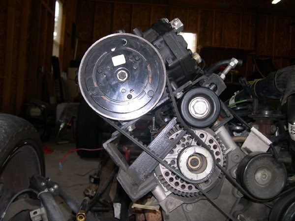

anyone done it and kept the a/c and heat....i have seen them run on the driveshaft but ot sure about a that...i use my truck and some time go off in the mud...so if there even a place or rom to run one......i got a pile or yorks like 8 or so and well tought make use of one and mount it on there to get a horn for these sorry ass drivers here

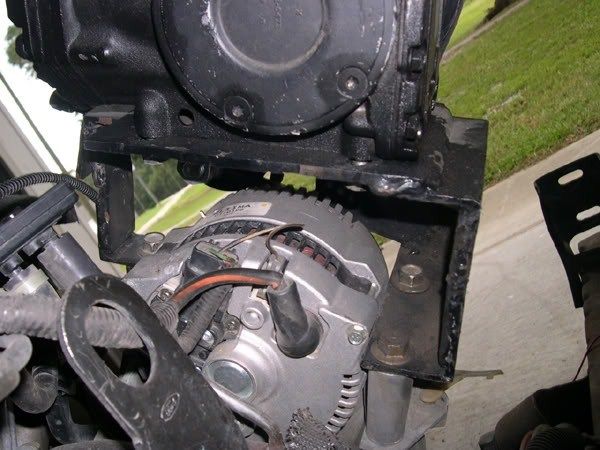

i have one on my 5.4.  its reverse mounted on the passenger side. i dont have any pics right now but i can get you one.

Id like to see a pic of your set-up.
homebuilt
the way poppasmurfs is set up, you will have to remove the fan shroud.  make your own bracket, weld a v belt pully to the alternator pully, and make your own tensioner pully.  good luck.

 I had a York 210 mounted off my alternator on my 01 f150 with the V6.Iwish i could find some pics of it before i took the cab off, but i had to bend an AC line out of the way and reroute the upper radiator hose. Kept A/C and all that good stuff.
