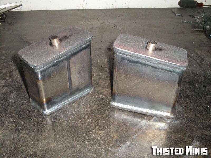

You want some nicer blocks? I built these based off a DJM 4" block and the guy never picked them up.

how much seth? the reason i was asking is i dont see making them shorter being easy, and the stock spring perch on mine doesnt hang lower than frame. i could make new bars from scratch, but i got these already. what side effects would it have with the pivot a little behind centerline if the top is on center?   also, i chose the stock bars i did because i see those heavy 4wd 4runners wheelin without bending them. they have more weight and power. and the minivan is the same. and those even have the coils on the bars. mine wont be for space issues. im trying to be low budget, but dont wanna be a hack.
