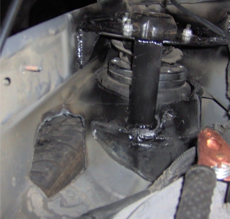

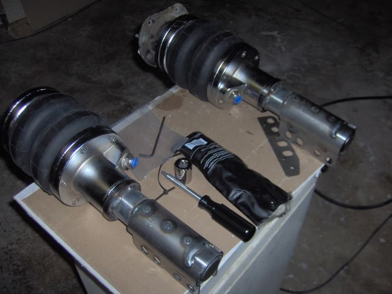

the struts i used are from aim/ chassis tech. when i was ready to spend some money they were the only "universal" kit you put together yourself i could find. i put about 400 miles on them before i raised the strut towers with no problems. i raised the towers and they rubbed the firewall so i built some spacers. now it doesnt lay out anymore. it would if the tire didnt hit the bag when i use the lower holes to mount the strut.

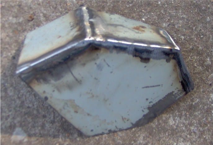

basically it is a pain, now the drive shaft bids when you ride low.  the worst part of raising the towers is that you can't get a grinder in there to clean up the galvanized coating so all the welds look like turds.   here is the tub to cover the tire

hey man i used the air lift kit on the matrix,,nice kit  worked great

--------------------------------------------- Originally posted by garagebuilt   the worst part of raising the towers is that you can't get a grinder in there to clean up the galvanized coating so all the welds look like turds.
---------------------------------------------   On mine, we just burned it with a torch and cleaned off with a brush. Welded fine
