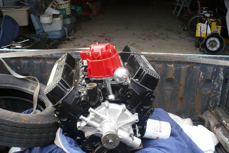

u dnt have to move the firewall only thing i did was had to notch frame like a 1/4 of an inch to get header down u will have to cut out the lip around where the tranny tunnel starts upfront i jus did this in my 95 thats bodied thats with a mock block in it thats what it was orginal was going to look like till i decided to open up the pockets

thats what the motor going in will look like except only 1 4 instead of 2 4's
