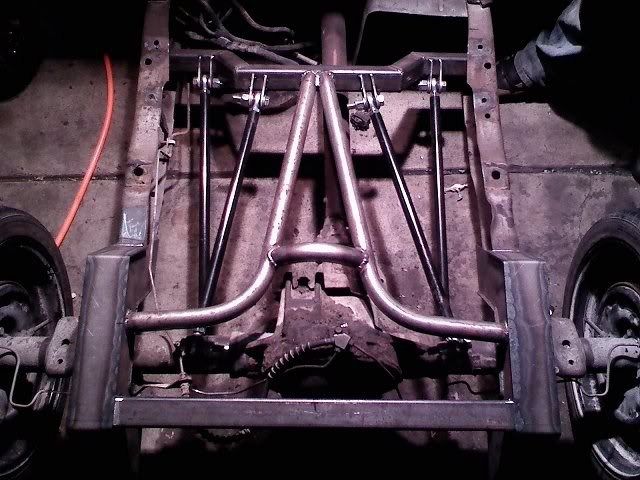

On a side note, why is the upper 4-link bar on the right side in closer than the upper left bar? You can really see the difference from the mitre cuts on the crossmember.

the upper bars are the same length, and one mounts over slightly farther because of the offset of the pig on the axle
