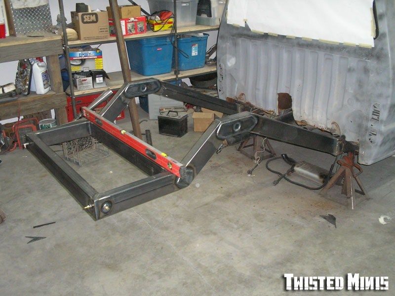

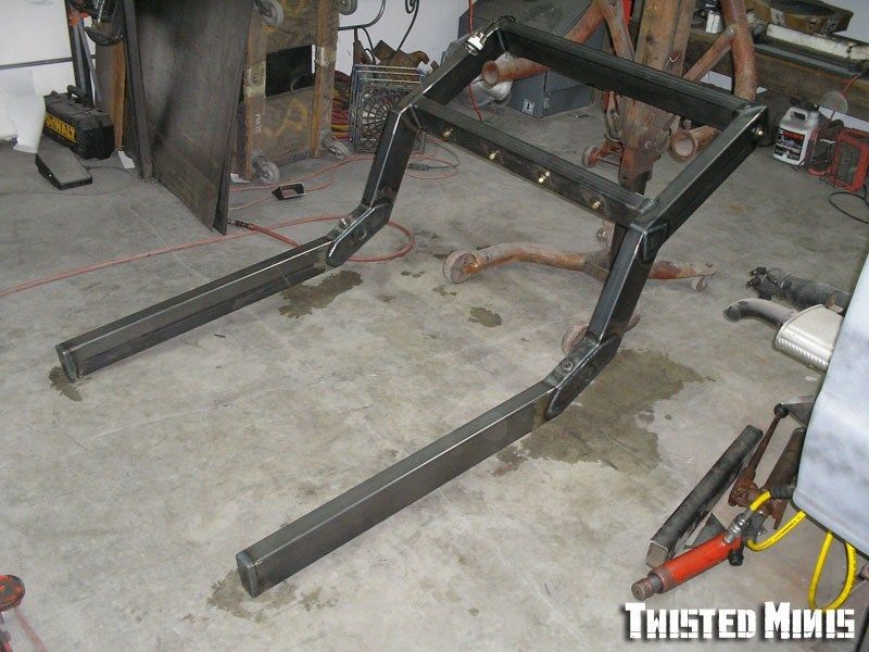

Measure stuff like the length of the frame, how wide it is, diagonal on the frame, your wheelbase, from the ground to the top of your axle. I built my last backhalf completely off the truck. I built it on a flat table, and it was much easier to square up. Then when joining it to the frame it was pretty easy to square up with the stock frame.

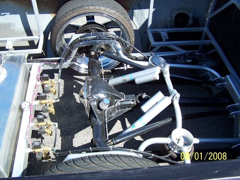

^^^ came out really clean! love the frame air tank and plumbing setup

Thats pretty much how I did the last S-10 I did, built it and pressure tested it off the truck.

thanks alot seth. thats exactly the type of things im looking for. if anyone else comes up with anything let me know. thanks again everyone...
