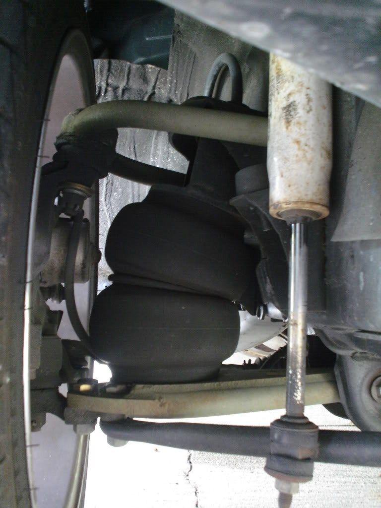

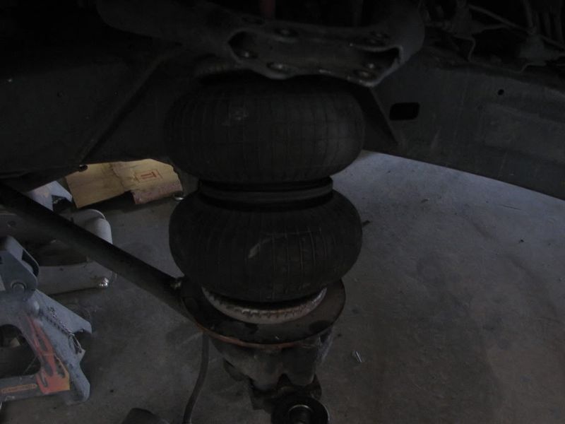

see if this works
e10pvmt's avatar
e10pvmt
mine had the spring pockets used and they tore off the frame....we then went with the torsion style setup which is highly recommended by me.....i could clear my 19's easily

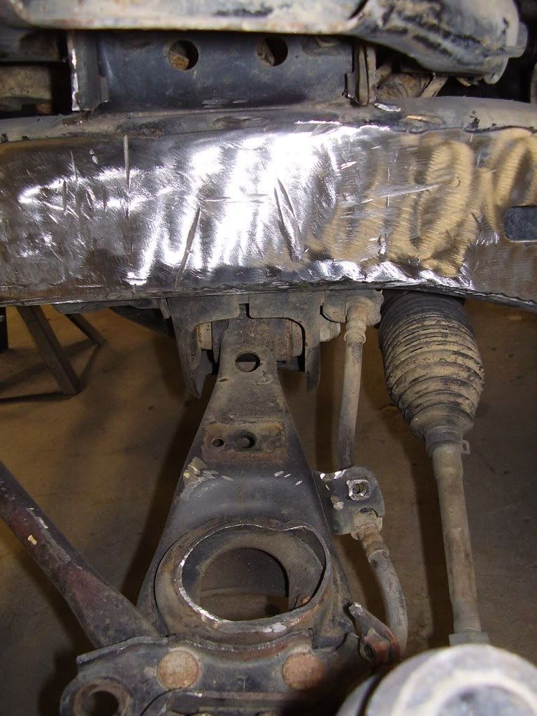

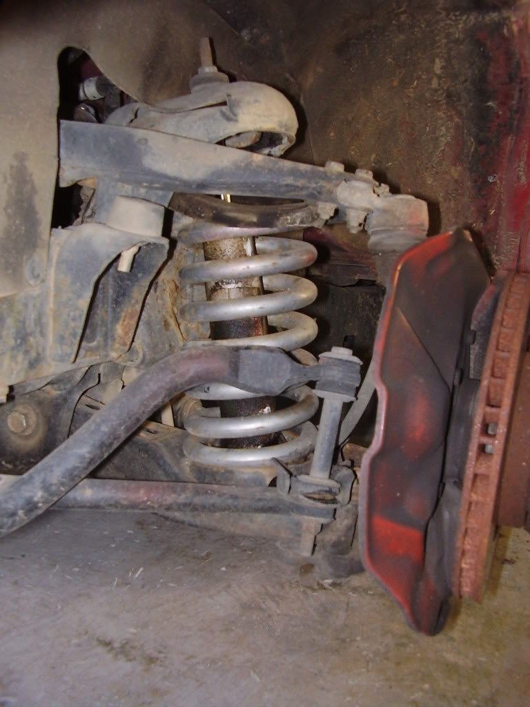

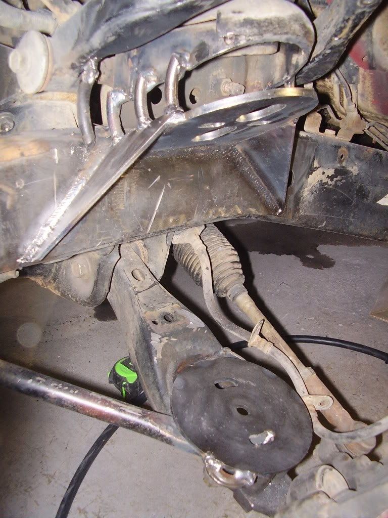

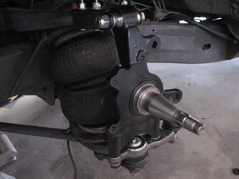

Here's how I did my taco......
Firts I removed all this shit
This is what it looked like when all th unessacary and unwanted shit was removed
And after the bag brackets were welded in.......

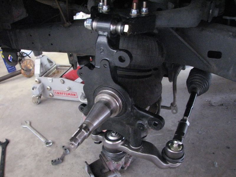

and of course, No Taco could be complete without a set of "Bio Kustoms Hand Made Drop Spidles" with uniball joints
And I can clear a 225/35/20 by atleats 2"
Well, I hope that help some if any at all

brian and mazzy that is exactly what i was looking for thanx man....i now see what was done wrong and what needs to be done to correct it....
