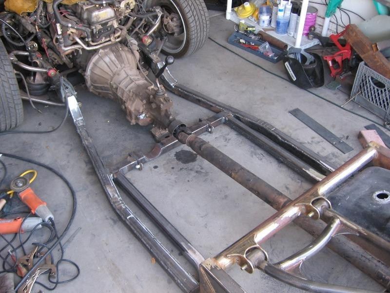

I would say do a stock floor Body drop. you dont need a frame table to build a stock floor frame. If you have a flat surface to build on and use a level and clamps, you can build a very nice strait frame without a table. OR you could chop the top off you factory frame and drop some tube in there and weld it up. thats how mine is done. The frame stays strait because you never change the shape of it.

hey andrew do u have any pix of your frame with the top cut and tubing put in?
