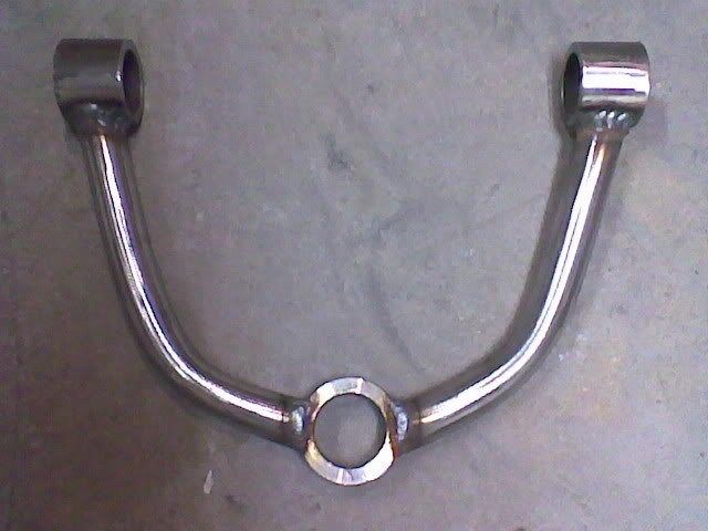

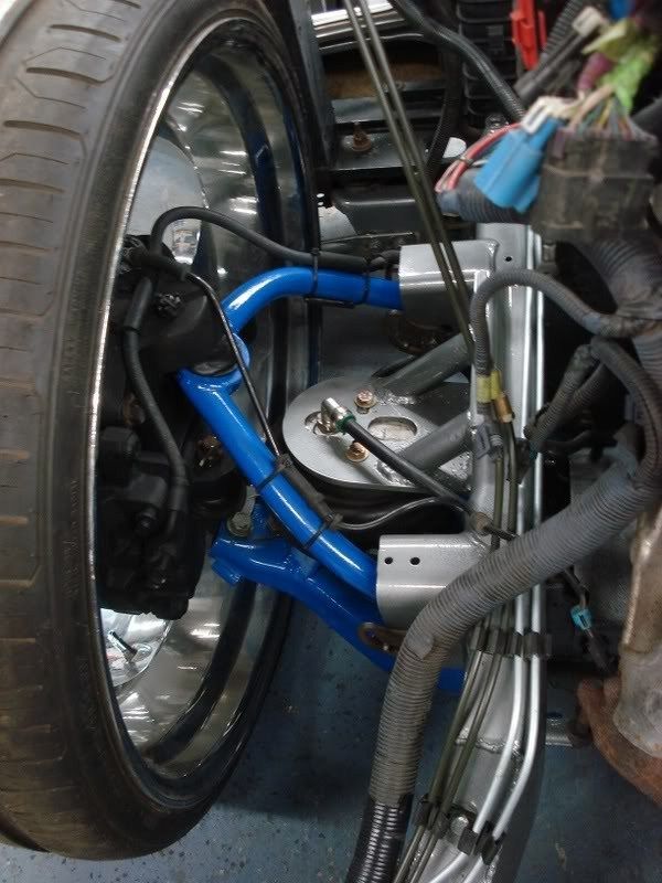

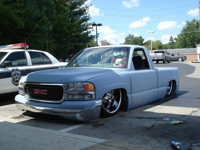

i have stock lowers recessed in 1" on the stock bracket, and custom built uppers that are 1" shorter than stock. Not much negative camber. I can turn quite a bit before it hits. Just barely enough lift to clear my 24x10 275/30r24 tires
