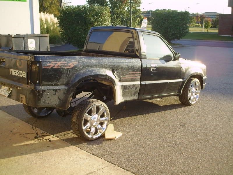

These are RE8s at 100 psi

nick, thats awesome lift man. are those bags at like 1/3bar from the pivot? One of the reasons I said run with the 8's is because you are running 5/8 line. The 8's have more volume inside. so adjusting your ride height will be easyier with a bigger bag. not to mention that you need 10.5 inches to untuck those 20's. When we throw the cab and bed and a full tank of gas at that thing who knows what psi you will need. Those airlift 2600 on there now are MAXED out height wise. 7 inch slams will get you a little more lift. But if you want to jack your truck up past those 20's at all you will need the 8's. Your setup is only 2/1 not 3/1 like nicks which i think is sweet lookn. l8r
