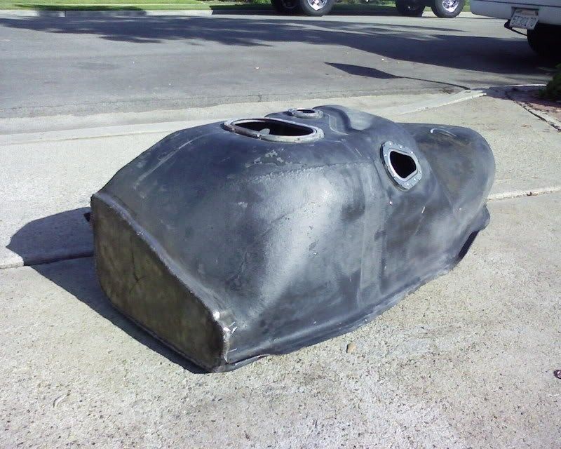

get por15 "metal ready" and "fuel tank sealer". heres my tacoma tank before sealer.
Bush
I took about 1.5" out of the middle of my 720 tank. We got it welded as good as we could and used por15 tank sealer as well. worked like a champ so far
