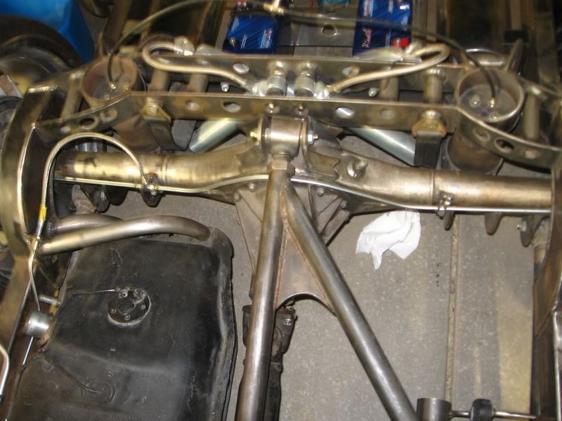

Mine mount from the bridge to the lower shock mounts. Its nice cause when i put the truck on stands i just let the air out and the straps hold the rear end from ripping the bag apart.
