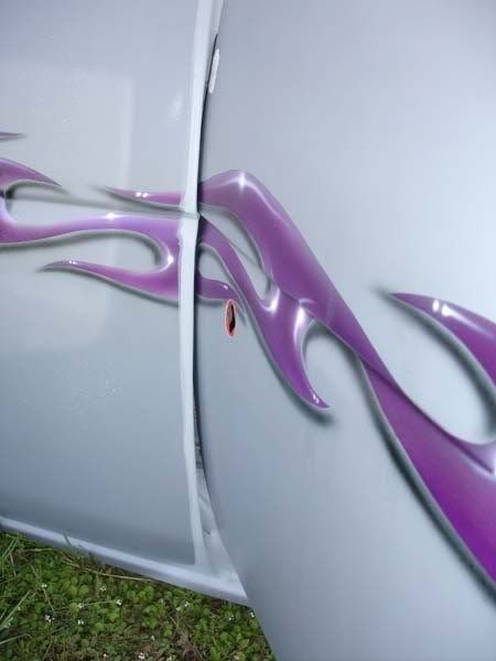

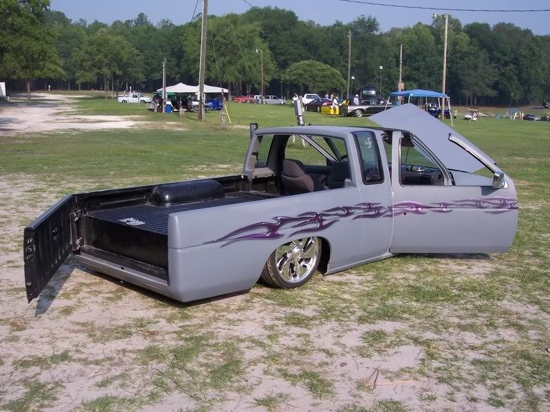

heres one we did with the stock nissan hindges, and kept the stopers too..

the nissan we did above, it acts as a regular door, swings just like it was forward, with the no sag , and no major bracing...
only prob is that targa top he cut out , body needs some support, cab flexes when the truck is parked on unlevel ground
but other then that, its been done for over 2-3 years with no problems...
he just need to finish the truck now.. haha

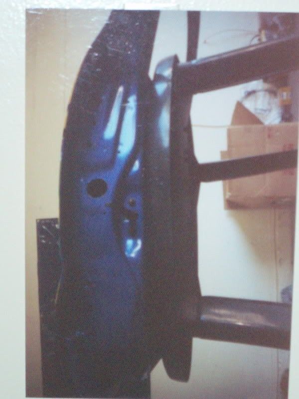

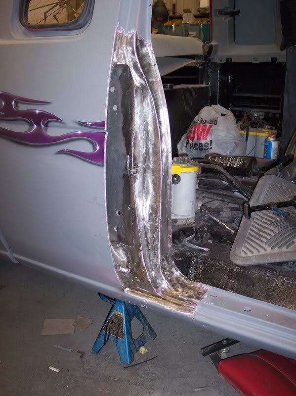

oh yeah, we did switch sides on the hindges... used some beat up donor doors...
basicly a 1/4 flat plate for the hindges to mount to ... and fab rest the metal to match up to it. is what we did
